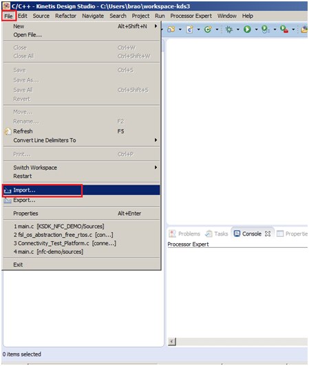

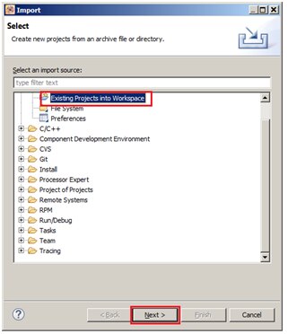

Select "File -> Import" from the KDS IDE menu. In the window that appears, expand the "Project of Projects" folder and select "Existing Projects Sets". Then, click the "Next" button

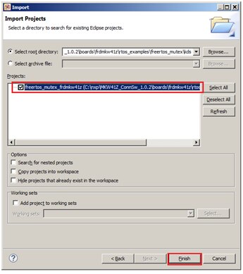

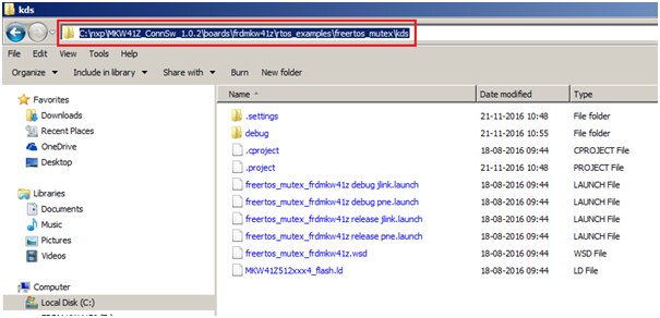

As we have installed the KW41 connectivity software at below location: point the browse option to this location or copy the path and paste it as shown in picture
“C:\nxp\MKW41Z_ConnSw_1.0.2\boards\frdmkw41z\rtos_examples\freertos_mutex\kds”
After pointing to the correct directory, your "Import Working Sets and Projects" window should look like the figure below. Click the "Finish" button.

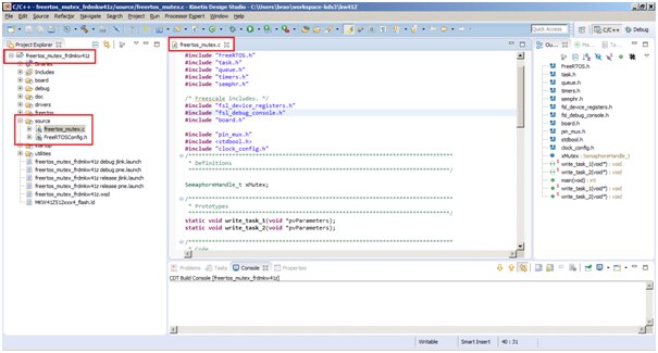

The workspace will look like figure shown below:
You can browse to source folder “freertos_mutex.c” where our main program is present
All the required includes can be found here: like supporting for kernel FreeRTOS and Freescale kinetis supported includes

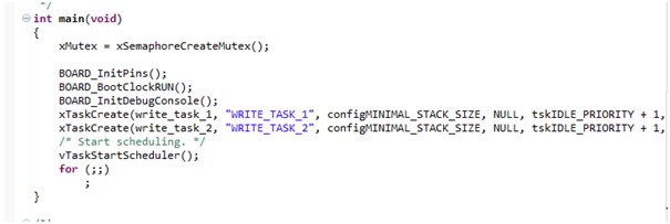

int main(void)
    xMutex = xSemaphoreCreateMutex();
    BOARD_InitPins();
 BOARD_BootClockRUN();
 BOARD_InitDebugConsole();
 xTaskCreate(write_task_1, "WRITE_TASK_1", configMINIMAL_STACK_SIZE, NULL, tskIDLE_PRIORITY + 1, NULL);
    xTaskCreate(write_task_2, "WRITE_TASK_2", configMINIMAL_STACK_SIZE, NULL, tskIDLE_PRIORITY + 1, NULL);
    /* Start scheduling. */
 vTaskStartScheduler();
    for (;;)

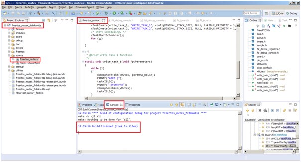

Now connect the KW41Z board to your machine USB port and click on hammer button to build the project to check whether the project is compiling and building without errors
You can see the result in console window as shown below:

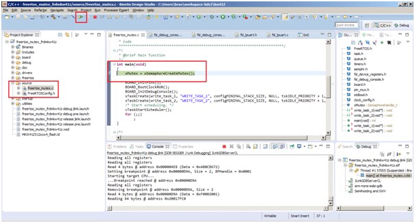

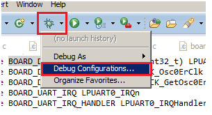

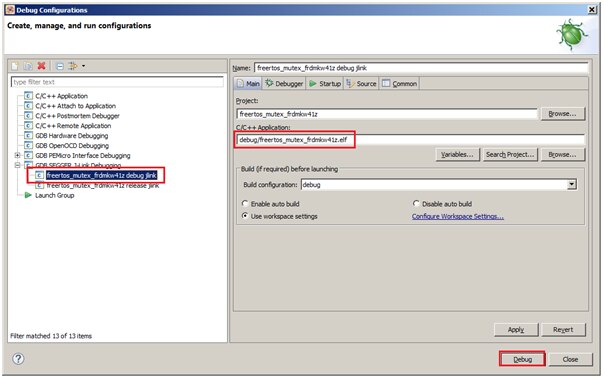

Now we will proceed to execute this project by clicking on debug configuration as shown:
Make sure to connect the development platform to your PC via USB cable between the OpenSDA USB and the PC USB connector.
Make the selection as shown
The application is downloaded to the target and automatically run to main(): You will see the execution window as shown below:

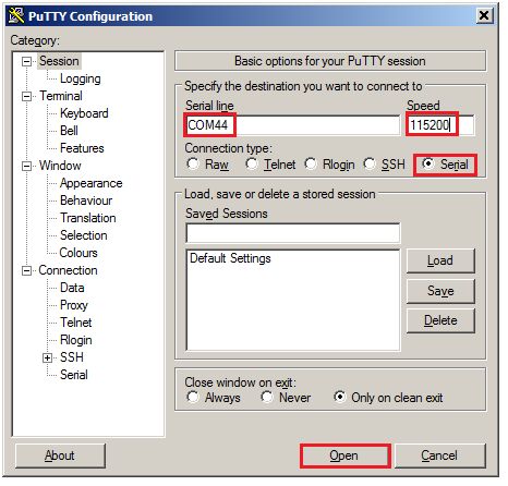

Now open an serial hyper terminal window to test this application:

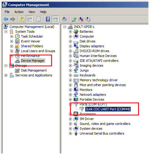

My board is connected to com44 port as shown in device manager:
I am having putty serial terminal application with me, open with below set up configuration:
