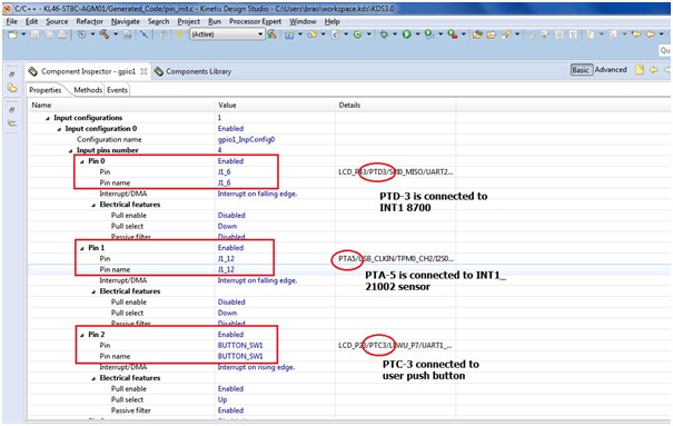

The interrupt pins of the sensor are connected as follows:
INT1- 8700  >  J1-6  > PTD3
INT1-21002  >  J1-12 >  PTA5

Fsl_gpio component
In the "Component Inspector" tab configure the GPIO component. The INT1_8700 output is connected to the PTD3 pin and the INT1_21002 pin to the PTA5 pin of the KL46Z MCU.
These both interrupt pins are configured as push-pull active-low outputs, so the corresponding PTD3/PTA5 pin configuration is GPIO with an interrupt on falling edge.

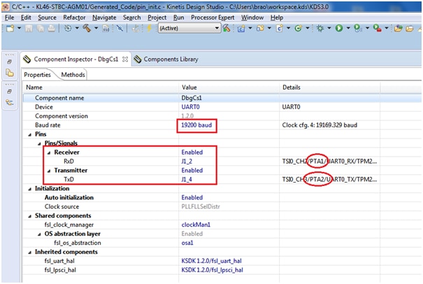

Fsl_debug_console
We are connecting the debug console to UART pins of KL46Z mcu to display the sensor output it is connected as shown
it is connected to PTA-1 > RxD and PTA-2 > TxD with baud rate of 19200

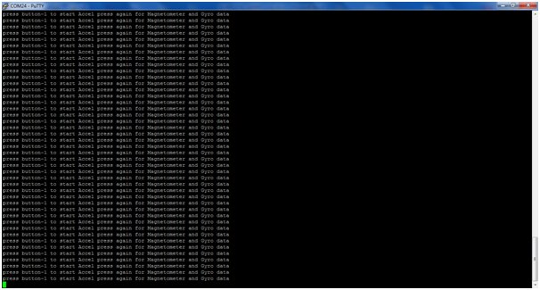

After compiling and executing the code you can see the output in an hyper terminal with baud rate of 19200 as shown below:
Mode-1 output window:
