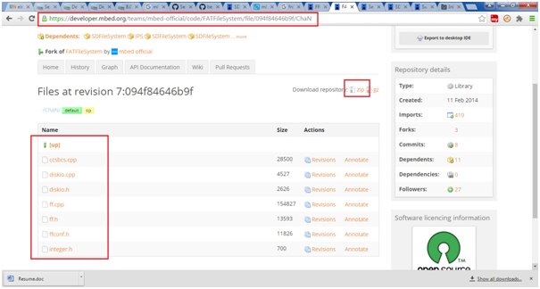

To proceed further we need FAT File System driver and SD File System drivers which need to be download from below links:
https://developer.mbed.org/teams/mbed-official/code/FATFileSystem/
and other FAT file system from below link:
https://developer.mbed.org/teams/mbed-official/code/FATFileSystem/file/094f84646b9f/ChaN
SD File system from below link:
https://developer.mbed.org/teams/Akafugu/code/SDFileSystem/
After downloading the contents of FAT and SD File system unzip them and copy all the *.cpp files into a ‘source’ folder inside our project folder
“C:\k64-sdcard-mbedos\source”
Create one folder inside the project folder named ‘sdcard-header’
i.e “C:\k64-sdcard-mbedos\sdcard-header”
copy all the *.h header files of FAT/SD File system inside this folder:

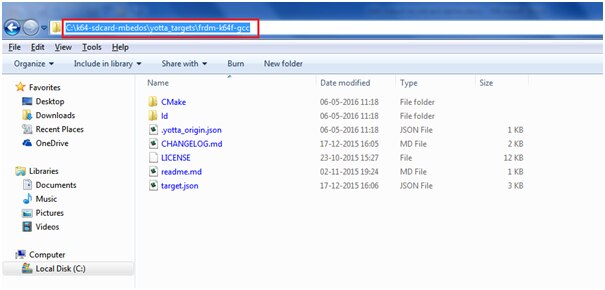

Browse the project folder to “C:\k64-sdcard-mbedos\yotta_targets\frdm-k64f-gcc”
You will find“target.json file which contains the hardware information about the target board here in our case is  FRDM-K64FFRDM-K64F board below is the snap shot of the target.json file
Add the below spi port information in the file:
mosi > connected to PTE-3
miso > connected to PTE1
sclk > connected to PTE-2
cs > connected to PTE-4
