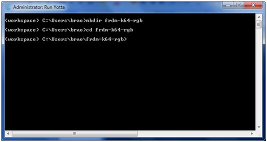

Create an application
First create a directory with the name we want, and cd into it. I have created directory by name “frdm-k64-rgb”
