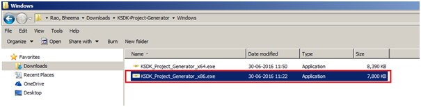

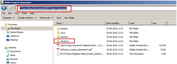

Download the KSDK_Project_Generator.zip package from KSDK web page,
http://www.nxp.com/webapp/Download?colCode=KSDK-PROJECT-GENERATOR-TOOL&Parent_nodeId=1465840412864730157257&Parent_pageType=product
Unzip the package to a location of your choice on your host machine.

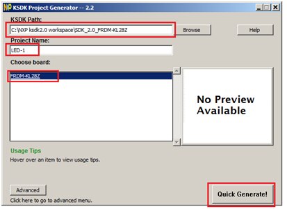

To run, open up the folder for your operating system (in my case it’s Windows) and execute the ‘KSDK_Project_Generator’ application.
Once the application is running, make sure to point the tool to a valid KSDK 1.2.0, 1.3.0 or 2.0.0 installation.
I have installed the SDK 2.0.0 for KL28Z board at below location:
“C:\NXP ksdk2.0 workspace\SDK_2.0_FRDM-KL28Z”

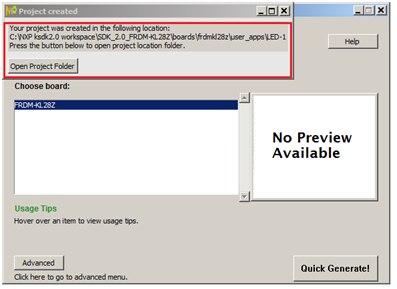

You will be prompted to the new project generated as shown below: and click on Open Project Folder

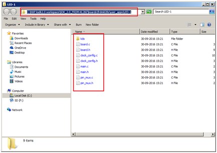

Now your project is created at folder
“C:\NXP ksdk2.0 workspace\SDK_2.0_FRDM-KL28Z\boards\frdmkl28z\user_apps”

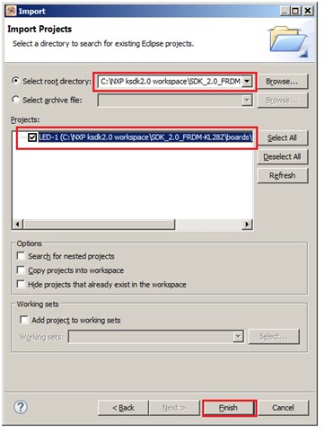

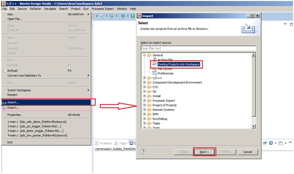

Select File->Import from the KDS IDE menu. In the window that appears, expand the "Project of Projects" folder and select "Existing Project Sets". Then, click the "Next" button.
Click the "Browse" button next to the "Import from file:" option.
Now direct the path of SDK V2.0 as shown

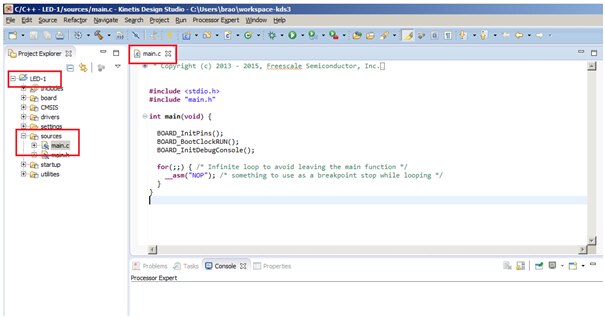

After successfully importing the project to your workspace the complete setup looks as shown below:

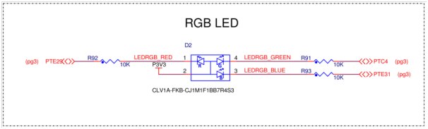

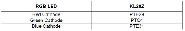

Now we will try to toggle all the three LED’s connected to the board.
Add below lines in main.c file

PORT_SetPinMux(PORTE, 29U, kPORT_MuxAsGpio); //RED
The above function set the portE-29 pin as output and similar with PortE-31 and PortC-4
LED_RED_INIT(LOGIC_LED_OFF);
The above function initialises the red led in off condition
Similar the case with Green and Blue led initialisation

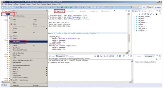

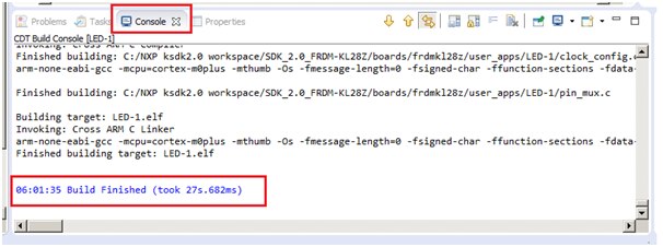

Save the file and compile it by pressing the hammer button or “Build Project” option
It will build with no errors:

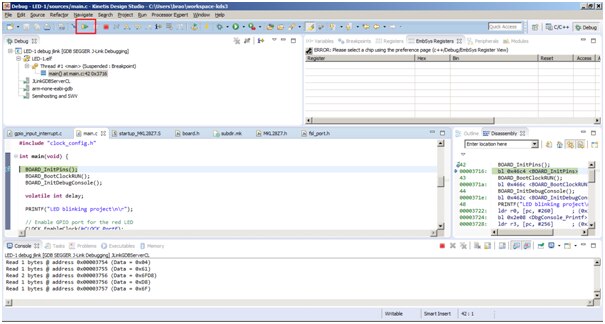

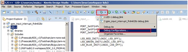

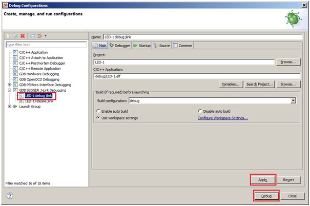

Now we will execute our project by configuring it for debug
Make sure the board is loaded with segger J-link driver, it appears in the debug configuration as shown:
Then press on resume button to execute:

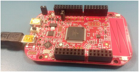

You will see all the 3 led’s toggles sequentially

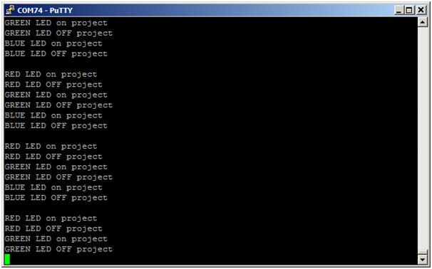

The same output can be seen in hyperterminal as shown:
