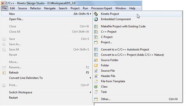

Create new project
  Create new project in KDS 3.0 with KSDK 1.2.0
Type the project name e.g.K22F-FTM example choose the board  FRDM-K22FFRDM-K22F mark off options Kinetis SDK and Processor Expert
Now, your project structure looks like this in the project explorer and Processor Expert windows:
