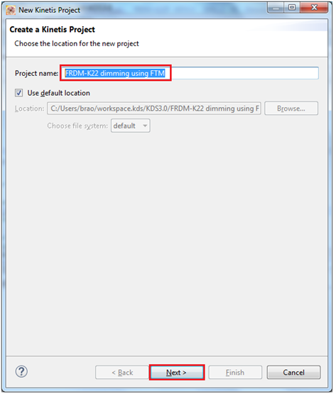

Create new project
Create new project in KDS 3.0 with KSDK 1.2.0
Type the project name e.g. ‘FRDM-K22 dimming using FTM’, choose the board FRDM-K22F, mark off options Kinetis SDK and Processor Expert

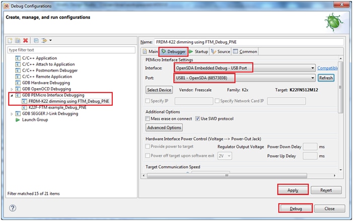

Debugging the FRDM-K22F board for the first time, you need to define a Debug Configuration by selecting the appropriate option from the toolbar
For this example, we are going to select the PEMicro OpenSDA Debug mode.
Select the Debugger tab to choose the Interface OpenSDA Embedded Debug - USB Port
You can now start the Debug session!!
Launch the configuration
