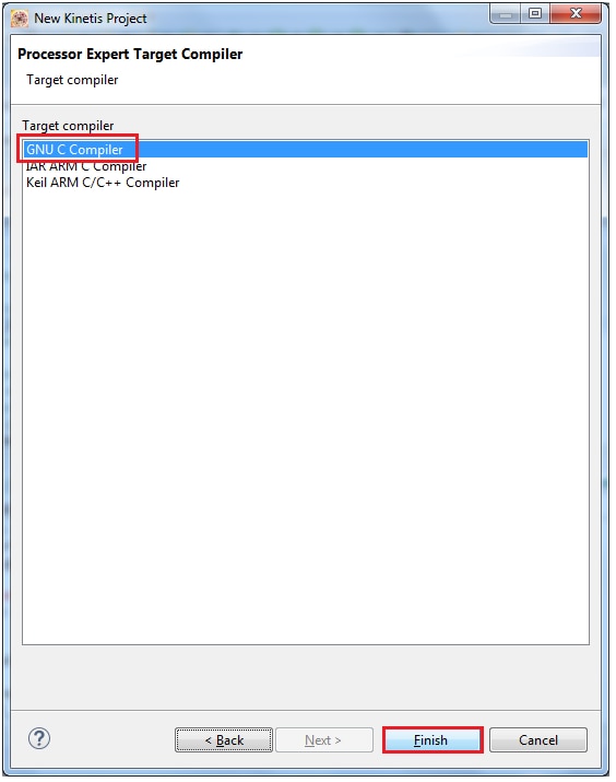

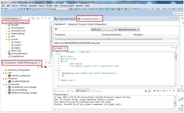

Step-1: Create a bare bone project
I have created a project by name “KL43Z-PWM using uart” using same steps as earlier
Now the project looks like as shown below

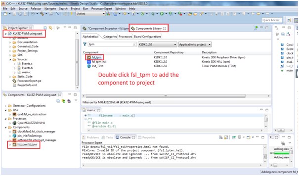

Step-2: Add the component debug_console, fsl_tpm to project
Now i am going to add the component fsl_debug_console and fsl_tpm from component library
Adding fsl_debug_console

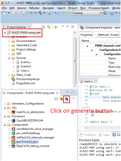

Click on the generate button as shown below:

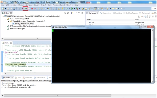

Step-5: Execute the project and see the result
Click on debug configuration and select the proper OpenSDA usb port from debugger tab as shown below:
Before clicking on the resume button make sure to open the hyper terminal of your choice with baud rate of 19200, 8N1
I have opened putty with the said settings:
Now click on the resume button as shown below:
