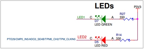

The Hardware connections of the KL43Z from schematic are:
GPIO pin connection of the board:
LED1 is connected to PTD-5 Green LED
LED2 is connected to PTE31 RED LED

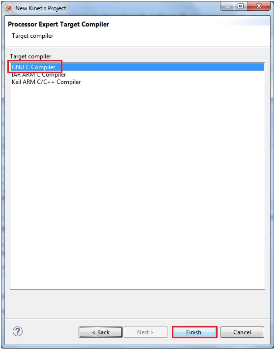

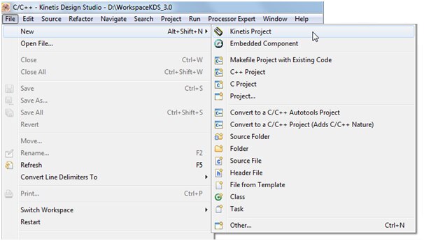

Step-1: Create a bare bone project
Step-2: Add the component debug_console, fsl_tpm, fsl_gpio to project
Step-3: Configure the hardware settings for UART and TPM user buttons
Step-4: Add the software code and compile/Build the project
Step-5: Execute the project and see the result.
I have created a project by name “KL43Z PWM using push button” using same steps as earlier
Now the project looks like as shown below

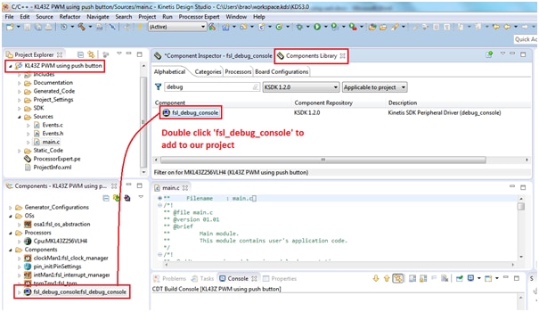

Now i am going to add the component fsl_debug_console and fsl_tpm from component library
Adding fsl_debug_console

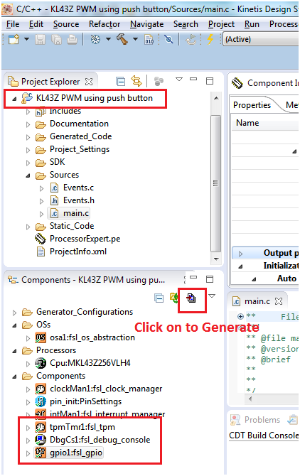

Adding fsl_gpio component

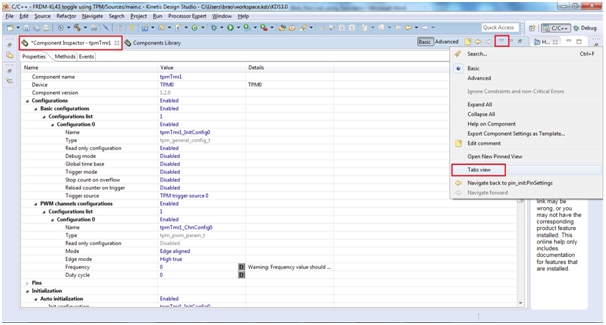

Settings for fsl_tpm
Double click on fsl_tpm component and make the below settings:
Enable to reload the counter on Trigger
Set the counter frequency to 1Hz with a Duty cyle of 50%
Allocate TPM0 Channel 5 to Pin LED2_Green (defined by board selection)
Select Clock source MCGIRCLK and choose the Prescaler Divide by 128
Enable the Initialization of TPM0 Channel 5
Save the configuration by pressing ctrl+s

Click on the generate button as shown below:

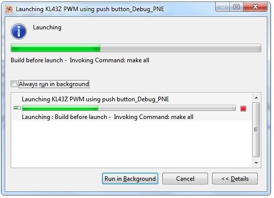

Now compile/build the project by clicking the generate button as shown below:
The project compiles with with no error, we will proceed further in execution the project:

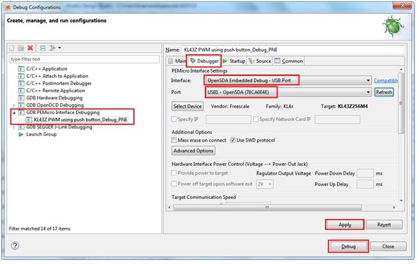

Click on debug configuration and select the proper OpenSDA usb port from debugger tab as shown below:

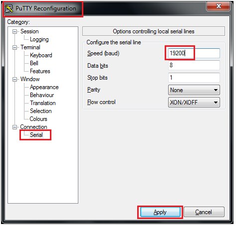

Before clicking on the resume button make sure to open the hyper terminal of your choice with baud rate of 19200, 8N1
I have opened putty with the said settings:
Now click on the resume button as shown below:
