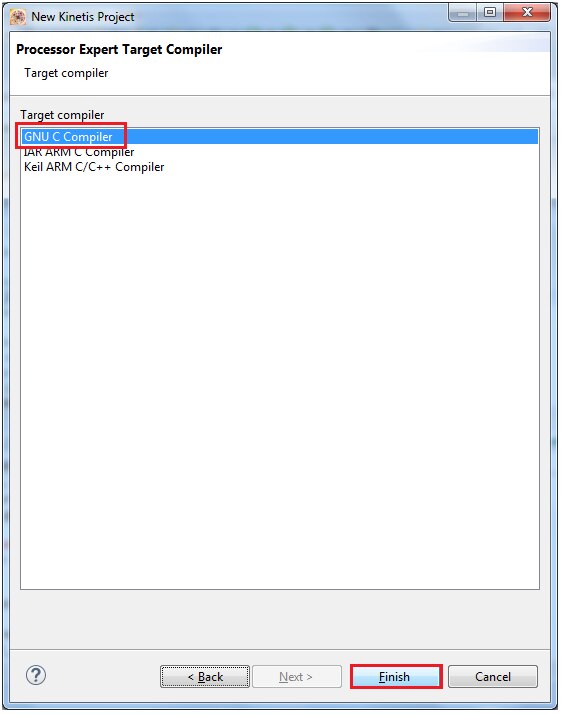

Step-1: Create a bare bone project
I have created a project by name “KL43Z GPIO using UART” using same steps as earlier
Now the project looks like as shown below

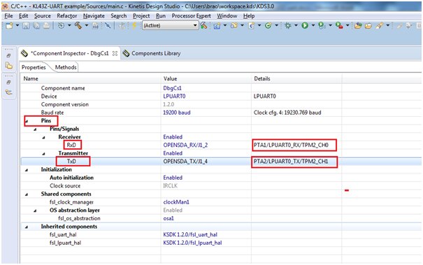

Double click on the selected debug component “fsl_debug_console “ and select the baud rate of 19200 as shown below:
Now select the uart pins for these settings:

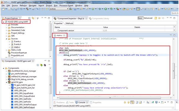

Now write the below lines of codes inside the main file to control the Green LED through Debug UART
The code is given below:
char led;
 GPIO_DRV_SetPinOutput(LED1_GREEN);
 while(1){
        debug_printf("\npress 1 to toggle: 2 to switch-on:3 to Switch-off the Green LED\r\n");
        if(debug_scanf("%s",&led)!=0);
        debug_printf("You have pressed %c \r\n",led);
        if (led =='1')
                      GPIO_DRV_TogglePinOutput(LED1_GREEN);
        else if(led == '2')
                GPIO_DRV_ClearPinOutput(LED1_GREEN);
        else if(led == '3')
        else
                debug_printf("\nyou have entered wrong selection\r\n");
This code will ask user to enter choices to Toggle, switch-on, switch-off the Green LED through UART communication. And the result can be seen on board with response on hyper terminal

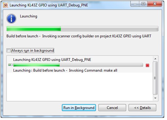

  Now compile/build the project by clicking the generate button as shown below:
The project compiles with with no error, we will proceed further in execution the project:

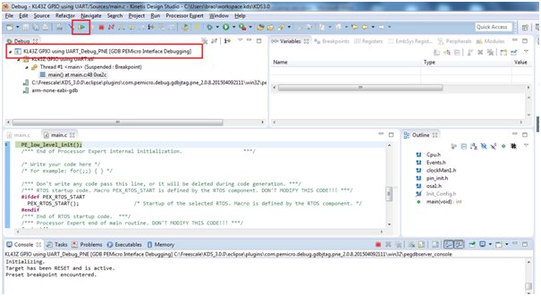

Step-5: Execute the project and see the result
Click on debug configuration and select the proper OpenSDA usb port from debugger tab as shown below:
Before clicking on the resume button make sure to open the hyper terminal of your choice with baud rate of 19200, 8N1
I have opened putty with the said settings:
Below is my video output seen on the hyper terminal window:
