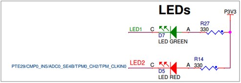

The Hardware connection of the KL43Z from schematic are:
GPIO pin connection of the board:
LED1 is connected to PTD-5 Green LED
LED2 is connected to PTE31 RED LED

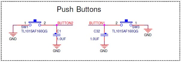

And push button schematic is as shown below:
You can observe that there is no Pull-up provided on the hardware for the GPIO connected to push buttons. We have to add a pull up to our requirement, this can be done while creating project in KDS tool in fsl_gpio component.

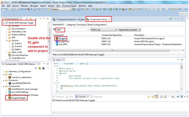

Step-2: Add the component fsl_gpio to the project
  Now i am going to add the component fsl_gpio from component library

As mentioned earlier from schematic there is no pullup conected to buttons hence we need to select the check box pull enable and pull select as shown in snap shot
As we need to enable interrupt click below opions
Button-1 is connected to PortA-4 and button-2 is connected to PortC-3

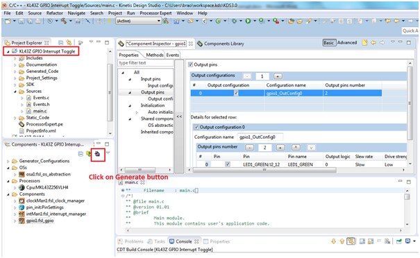

OUTPUT configuration:
Now we need to configure the output LED pins:
Green LED is connected to PTD-5 and RED LED is connected to PTE-31 as shown in schematic
Click on the generate button as shown below:

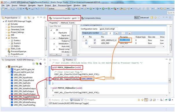

Step-4: Add the software code and compile/Build the project
After generating the code you can see the interrupt routines skeleton structure wil be generated inside “Events.c” as shown below:
We need to add our toggling the led function inside these routines:
Drag the GPIO_DRV_TogglePinOutput() from components to PORTA interrupt routine handler as shown below:
Similarly add the function for PORTC interrupt handler as shown below:
We have connected PORT-A to Green led which in turn connected to button-1 SW1 and PORT-C is connected to Red LED in turn connected to SW-2 push button

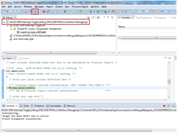

Step-5: Execute the project and see the result

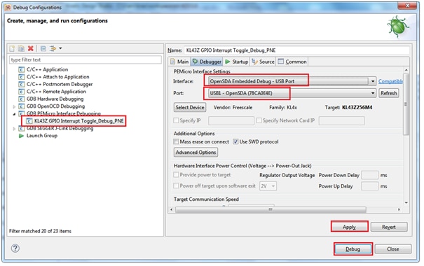

Click on debug configuration and select the proper OpenSDA usb port from debugger tab as shown below:
Below is my video output seen :
