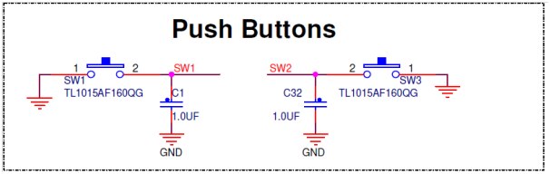

And push button schematic is as shown below:
PTC3 and PTC12
You can observe that there is no Pull-up provided on the hardware for the GPIO connected to push buttons. We have to add a pull up to our requirement, this can be done while creating project in KDS tool in fsl_gpio component.

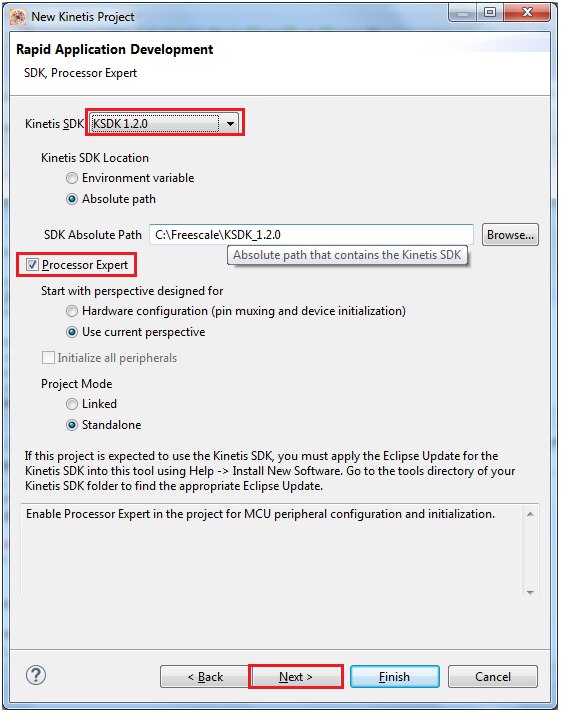

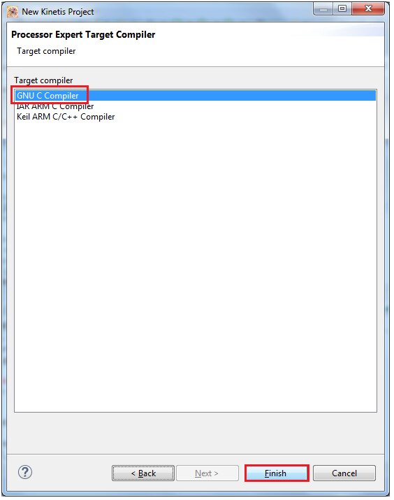

Step-1: Create a bare bone project
I have created a project by name “KL46-toggle using interrupt” using same steps as earlier
Now the project looks like as shown below

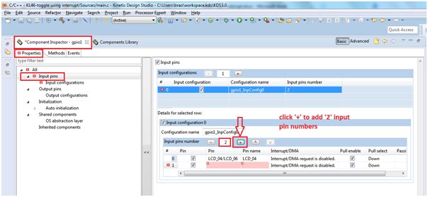

Step-3: Configure the hardware settings for LED and Push Button in fsl_gpio components
Double click on the selected component “fsl_gpio“ and make the settings for input and output side:
Below are settings for input configuration
Now select the input buttons from the dropdown list and select SW1 and SW2 as shown below:
As mentioned earlier from schematic there is no pullup conected to buttons hence we need to select the check box pull enable and pull select as shown in snap shot

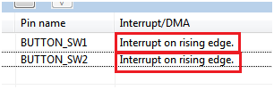

We have selected the interrupt mode as “Interrupt on rising edge”
As we need to enable interrupt click below opions
Button-1 is connected to PortC-3 and button-2 is connected to PortC-12
Select PORTC to generate code

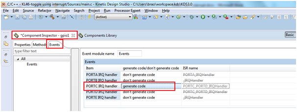

After generating the code you can see the interrupt routines skeleton structure will be generated inside “Events.c” as shown below:
We need to add our toggling the led function inside these routines:

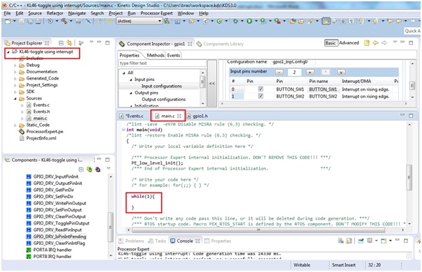

And inside main() just put infinite loop while ()

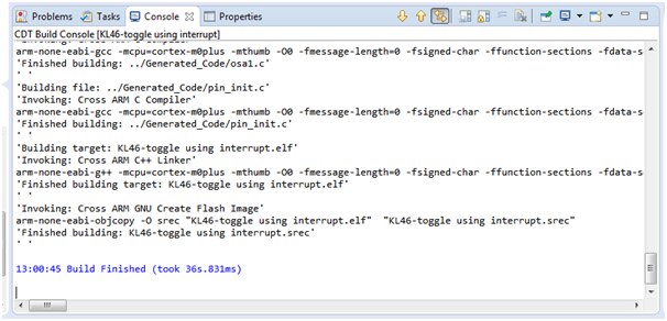

Now compile/build the project by clicking the hammer button as shown below:
The project compiles with with no error, we will proceed further in execution the project:
