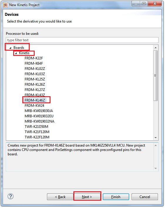

Create new project in KDS 3.0 with KSDK 1.2.0
Type the project name” K46Z- example for PIT”, choose the board FRDM-KL46Z, mark off options Kinetis SDK and Processor Expert

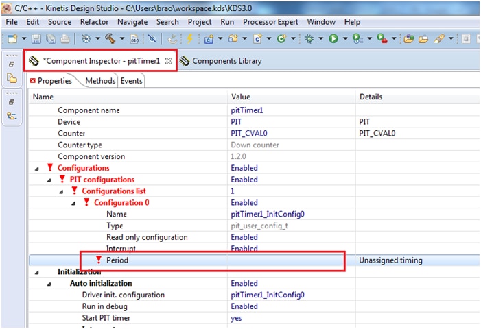

Double click on fsl_pit module from components windows and Component Inspector view should open automatically and uncheck the option for Tabs view which switches to classical view.
Configure the PIT module and click on “Period” option under configuration section as shown below:
Change the value to 1 sec by clicking on image button ...
Now all the red markings will vanish which indicates it is error free

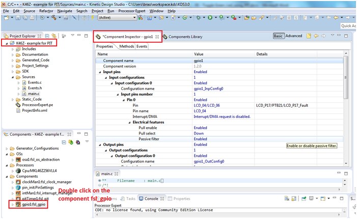

Now double click on the fsl_gpio module it looks like below:
Make the settings as shown below:
output pin 0 is configured to LED1_GREEN port pin PTD-5 which is connected to Green LED
and i.e disable the input pins as shown in below picture

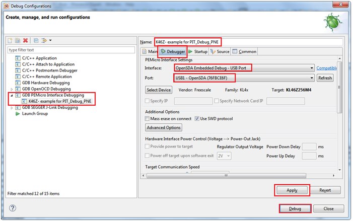

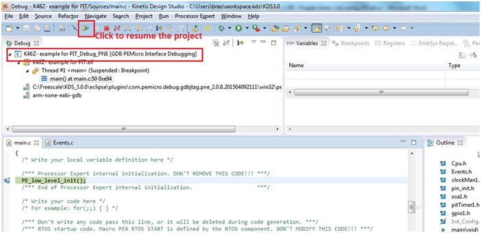

Execute the project and see the result
Click on debug configuration and select the proper OpenSDA usb port from debugger tab as shown below:
You should now able to see the Green LED blink with a 1Hz frequency i.e for every 1 sec of interrupt the LED toggles.
