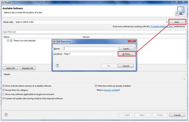

Before using KDS IDE with KSDK, the KSDK Eclipse Update must be applied. Without this update, Eclipse cannot generate KSDK-compatible projects.
To install the update, follow these instructions:
Select "Help" -> "Install New Software"

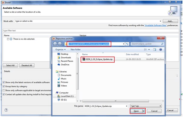

In the Install New Software dialog box, click the "Add" button in the upper right corner. Then, in the Add Repository dialog, select the "Archive" button.
In the Repository archive dialog box, browse the KSDK install directory folder and select the KSDK_1.3.0_Eclipse_Update.zip file.
Click "Open", and the "OK" button in the Add Repository dialog box. Then The KSDK update shows up in the list of the original Install dialogs. Check the box to the left of the KSDK Eclipse update and click the "Next" button in the lower right corner.
Follow the remaining instructions to finish the installation of the update.

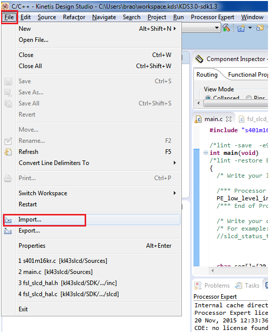

Select "File->Import" from the KDS IDE menu. In the window that appears, expand the "General" folder and select
"Existing Projects into Workspace". Then, click the "Next" button.
Click the "Browse" button next to the "Select root directory:" option. And choose the folder
“C:\Freescale\KSDK_1.3.0\lib\ksdk_platform_lib\kds\KL43Z4” as shown below

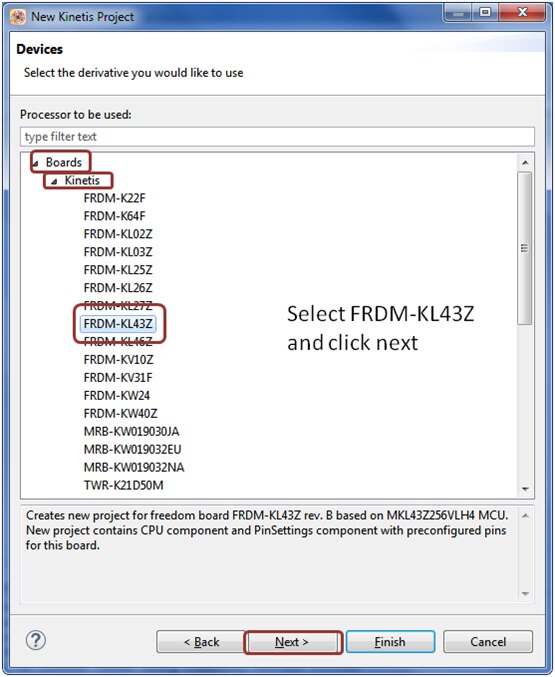

Create new project in KDS 3.0 with KSDK 1.3.0
Type the project name “SLCD Test-KL43Z” choose the board FRDM-KL43Z, mark off options Kinetis SDK and Processor Expert as shown in below snaps

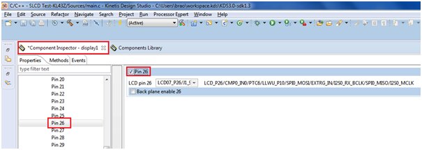

And for remaining segment connection for pins assigned to (not as Backplane)
Pin-20, pin-24, pin-26, pin-27, pin-40, pin-42, pin-43, pin-44

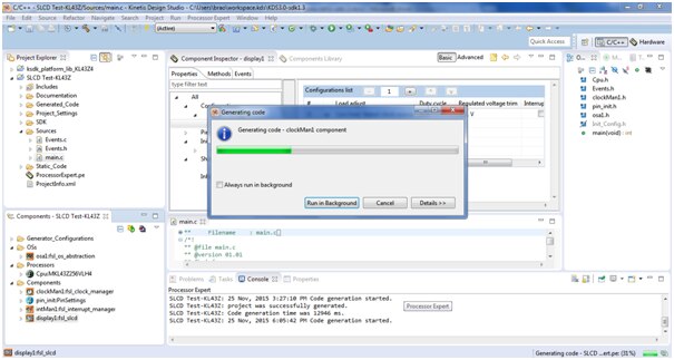

All the lcd configuration is now completed. We shall proceed to generate the corresponding code by clicking on the ‘generate code’ as shown below:
The tool generate code as shown below

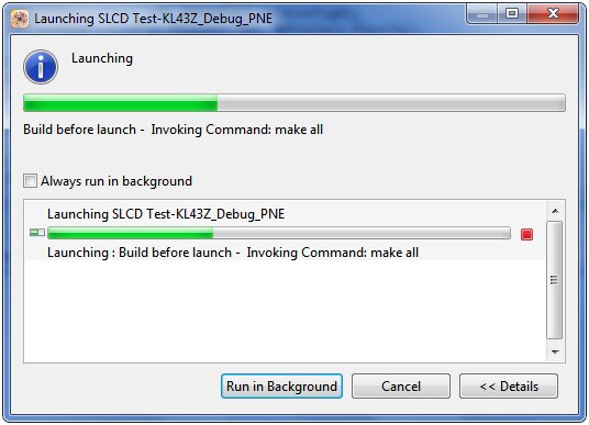

Now compile and build the project by clicking the hammer button as shown below:
You can see the build result in console window as shown below:
Now we will execute our code by debug method:
Next select the PEMicro debugging interface and OpenSDA type as shown below:
After clicking on debug the system launches our project and below window appears.
You will see a Debug execution window, press Resume button as shown below:
You can see the segments of LCD glows one-by-one as shown in the output video:

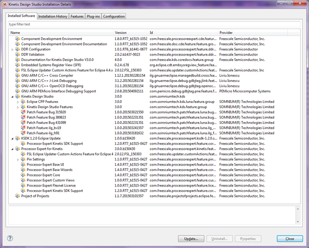

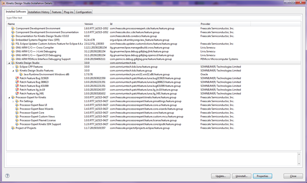

    bheemarao over 10 years ago in reply to bheemarao
    Hi Sankara,
    Below is my snapshot after installing KSDK1.3.0, you can see KSDK1.3.0 Eclipse update exists in my installation.
    from your snap shot is seems KSDK1.3.0 is not installed nor Eclipse updated for KSDK1.3.0
    have you proceeded for step-2 i.e after installing KSDK1.3.0 you need to do Eclipse update by navigating to Help>Install New Software..
    Best Regards
    Bheema Rao

    Step-2: Eclipse Update
    Navigate to
