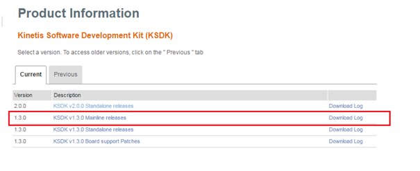

Proceed to install KSDK from below link:
click Here
https://nxp.flexnetoperations.com/control/frse/product?entitlementId=123812727&lineNum=1&authContactId=73533311&authPartyId=61860331
I have installed KSDK version 1.3.0 it gets installed in below folder:

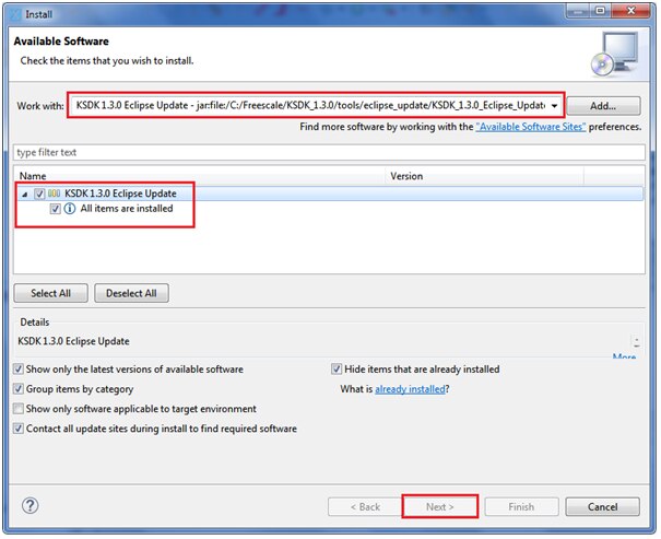

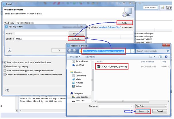

The Kinetis SDK comes with an update package for Eclipse. On Windows, it is as shown below:
Install that package in LPCXpresso using the menu
Help > Install New Software
and then install that archive: as shown in below snap shot
Press ‘Next’ and go through the installation process.

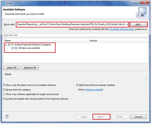

Now we need to install plugin for this from LPCXpresso the menu Help > Install new Software and install the freescale_updater.zip first
Proceed further
Go through the installation process. Then, do the same, but this time install the PEx_for_Kinetis_3.0.0.zip:
Proceed further

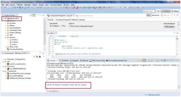

Now the LPCXpresso platform is ready to work on with Kinetis SDK, we can create New project and test the execution.
Just to demonstrate it works properly with KSDK we will try to create a project for toggling an LED

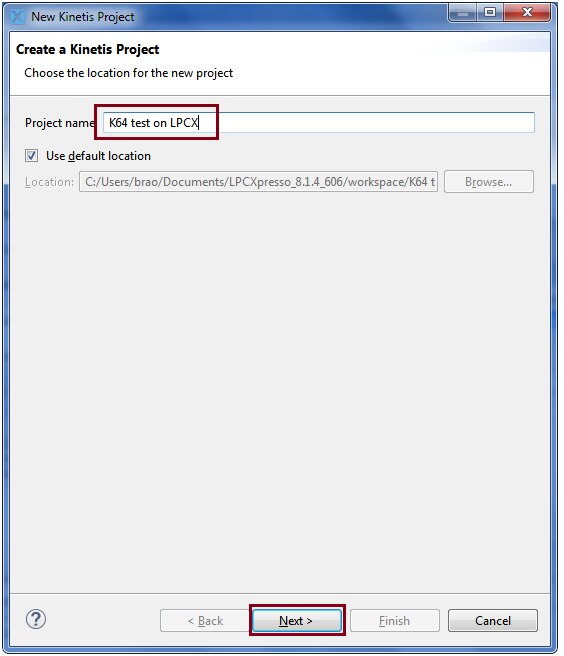

Follow below snaps to create New Project
Select‘boards and pop down to  FRDM-K64FFRDM-K64F
Select KSDK 1.3.0 as kinetis sdk
  And make sure to click on Processor expert button

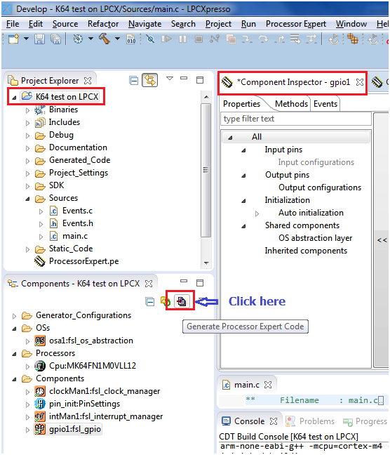

Now the project is created

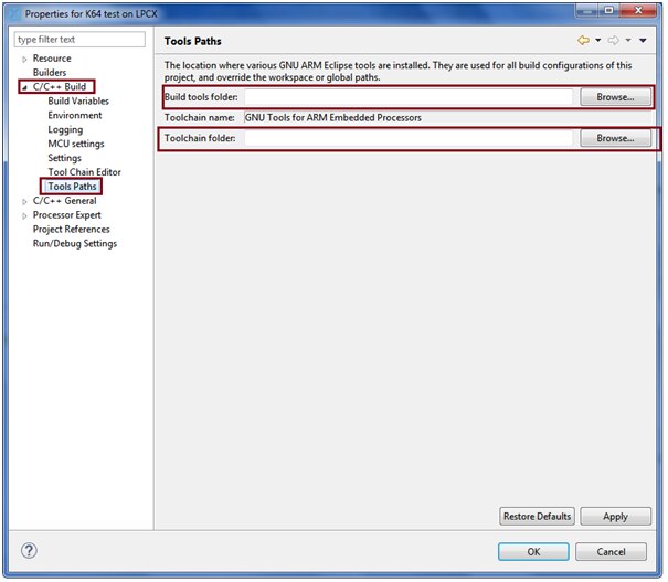

You can see there is a red cross mark on the project created this is because we need to assign Build path and Toolchain path for this working set
LPCXpresso is using its own custom GNU toolchain and libraries, and not the de-facto standard one from ARM (GNU ARM Embedded from launchpad. The GNU ARM Eclipse make it easy to use different tool chains.
I will be giving the path of installed one of KDS 3.0 which can be found in your machine i.e
C:\Freescale\KDS_3.0.0
We need to provide paths here:
For build tools folder select “C:\Freescale\KDS_3.0.0\bin”
And for Toolchain folder “C:\Freescale\KDS_3.0.0\toolchain\bin”
Apply and click on ok
With this, the project should compile with out errors

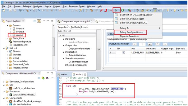

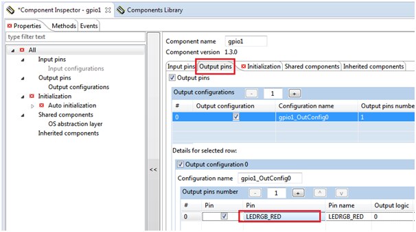

Now in order to toggle the led we are going to add the fsl_gpio component from component library:
Open the component inspector for fsl_gpio to configure a Led to our project
Now to toggle just add below lines to main.c
for(;;) {
GPIO_DRV_TogglePinOutput(LEDRGB_RED);
                   for(int i=0;i<=10000000;i++);
Make sure you have loaded FRDM-K64 with J-Link driver for debugging purpose
Visit below link to download the firmware for K64F (j-link/mbed drivers)
http://www.nxp.com/products/software-and-tools/run-time-software/kinetis-software-and-tools/ides-for-kinetis-mcus/opensda-serial-and-debug-adapter:OPENSDA?tid=vanOpenSDA
click on debug configuration as shown below:
Now select “K64test on LPCX” under GDB SEGGER J-Link Debugging as shown below:
Click on resume button to run
Click on the resume button to ‘Run’ the project or ‘Step into’ and ‘Step over’ button for single stepping execution:
Now you can see the RED led toggling with some delay.
