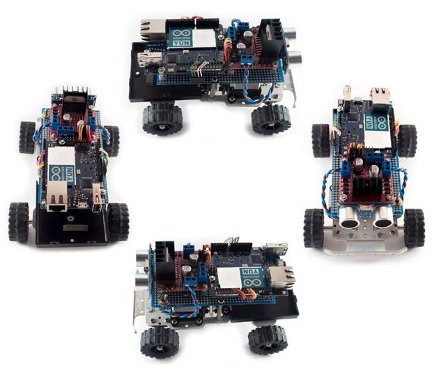

So what is a miniRobot?
  • 4WD robot chassis with two DC motors.
  • Dual DC Motor Driver (H-bridge type).
  • The heart of the system: Arduino Yun.
  • Echo sensor: HC-SR04.
  • Power supply: 2S LiPo battery.
  • Some little things.
My regular readers probably know that I wanted to use Arduino Yun in my tricopter's OSD system (link), But after some reflections I rejected this solution: and the reason was simple: Yun is excessively powerful board for this project. So, look at pictures of my miniRobot:

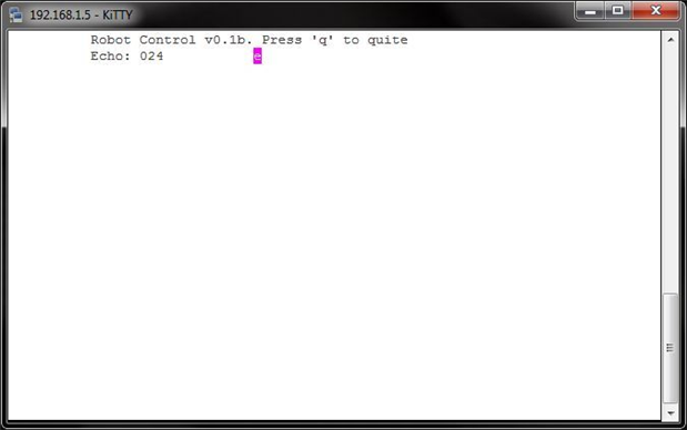

RC-software works in the following way: you are connecting to the robot via SSH (you can use KiTTY for this goal), run the python script and after that you use your keyboard to move the robot. Pretty simple! I made an interesting experiment: I provided access in my LAN to my friend who lives in South Africa. He connects to my WEB-camera and to the SSH terminal of my robot. He was able to control my robot from another point of the planet! After this experiment I know that we live in a world of the future image
The second program is created for the bypassing the obstacles: if the robot sees the wall in his way it stops then moves back and rotates by ~90 degrees (actually, everything is more complicated, but the essence is not in it), after that the robot goes forward and the cycle repeats. For more info look at this picture with my nanoRobot:
