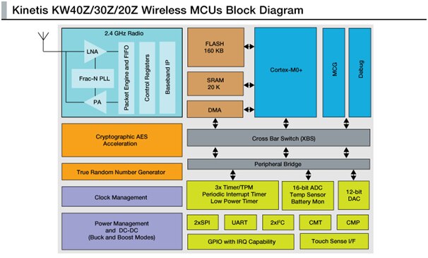

This blog brings you a short out-of box demo Wireless Connectivity Example Demos on the  FRDM-KW40ZFRDM-KW40Z for newly introduced freedom board  FRDM-KW40ZFRDM-KW40Z which is a low-cost development platform enabled by the Kinetis W series KW40Z/30Z/20Z(KW40Z family built on the ARM Cortex-M0 processor The KW40Z is an ultra low-power highly-integrated single-chip device that enables Bluetooth Smart/Bluetooth Low Energy(BLE v4.1 and IEEE 802.15.4-2011 RF connectivity for portable extremely low-power embedded systems
The KW40Z processor family is based on an ARM M0+ core running at 48MHz.  The processor integrates a buck-boost DC/DC converter, supporting a wide range of operating voltages from 0.9 V to 4.2V The KW40Z MCU integrates a 2.4 GHz transceiver supporting a range of FSK/GFSK and O-QPSK modulations, an ARMRegistered CortexRegistered-M0+ CPU, 160 KB Flash and 20 KB SRAM, BLE Link Layer hardware, 802.15.4 packet processor, hardware security and peripherals optimized to meet the requirements of the target applications.
These processor family offers Dual mode Support which allows the system to concurrently participate in an 802.15.4 based network and BLE, eliminating the need for multiple radios, reducing system complexity and ultimately cost.
Take advantage of the robust enablement package that includes the BLE Host Stack, 802.15.4 MAC and Simple MAC (SMAC) software protocol stacks, RTOS, Kinetis Software Development Kit (KSDK) and development tools from IAR.

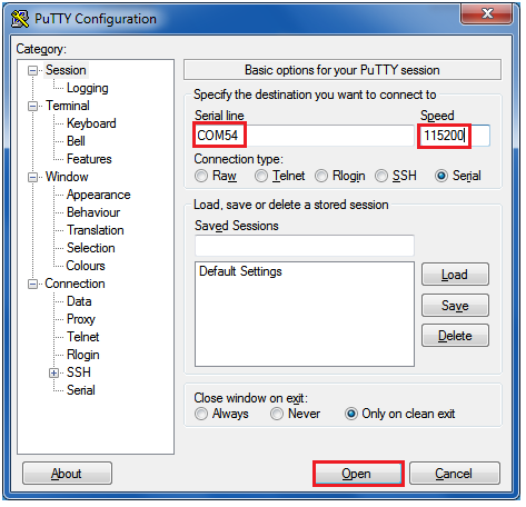

Plug in both the boards to your computer and open the device manager from your control panel, you can see there are two com ports connected as shown below (in my case it is com53 and com 54)
Open any hyper terminal application from your computer, in my computer i am having putty terminal
Configure to open COM54 port connected board:
Similarly open the COM53 port connected board from your putty terminal.

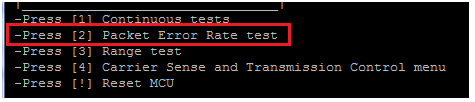

To start any test, you can follow the on-screen instructions. We are going with Packet Error Rate test

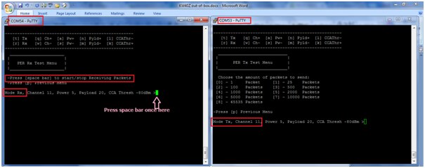

Both of the board comes in Tx mode by default as shown below:
In packet error rate we are transmitting XX numbers of packet from transmit window and checking the same number of packets are been received in receive window, and if there is error in receiving packets it will give the error rate.
For this we need to configure one of the board to be in RX mode for configuring press button ‘r’ on one of the terminal to change in rx mode as shown below:
In my setup COM54 is configured as receiver terminal and COM53 as Transmit terminal as shown above
Now press ‘2’ on both terminals to run as “Packet Error Rate Test”
You can see different options on the RX board now press ‘space bar’ to start receiving packets i.e the terminal is in receiving mode and keep in listening for the packets on the channel

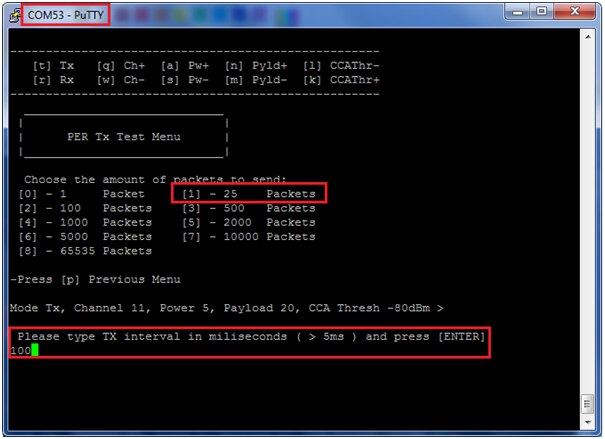

Press ‘1’ here in transmit terminal to send 25 packets it will ask TX interval in milliseconds i have given 100ms. Now press enter to send packets

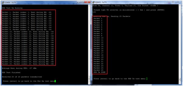

Now you can see the sending packets from transmit window and same thing is received in receive window i.e in COM54 port terminal both happens simultaneously as shown below:
You can see the packet index along with RSSI during RX and average RSSI of the PER
