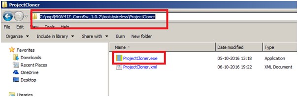

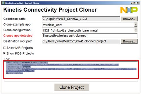

Navigate to the KW41Z Connectivity Software installation folder and run the Project Cloner application (C:\nxp\MKW41Z_ConnSw_1.0.2\tools\wireless\ProjectCloner).

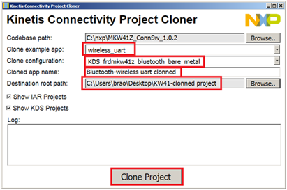

Select the below options for project cloner
After the Codebase path has been selected correctly, the Project Cloner will display all the Connectivity Software example applications.
Next select the example application to be cloned (Clone example app), and the desired configuration (Clone Configuration).
By default both IAR and KDS projects are shown in the Clone configuration dropdown menu. I have selected for KDS tool chain
IMP Note: you need to do a clean build of a project BEFORE you clone it to create the debug folder and files like MKW41Z512xxx4_connectivity.ld in the original

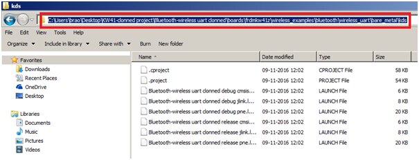

I have changed the destination root path to “C:\Users\brao\Desktop\KW41-clonned project” and given the cloned project name as “Bluetooth-wireless uart cloned”
Now click on Clone Project
You can see the clonning successfully in log window: You can see the cloned project in folder
“C:\Users\brao\Desktop\KW41-clonned project\Bluetooth-wireless uart clonned\boards\frdmkw41z\wireless_examples\bluetooth\wireless_uart”

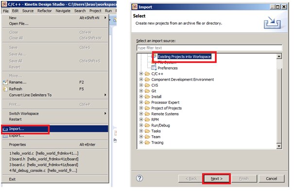

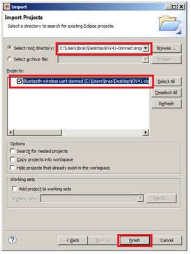

Open the KDS tool and import the cloned project as shown below
Import the project into Workspace: File -> Import -> General -> Existing Projects into Workspace
Browse for the cloned project path:
“C:\Users\brao\Desktop\KW41-clonned project\Bluetooth-wireless uart cloned”

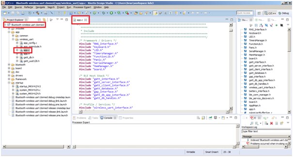

The KDS project window looks as shown below:

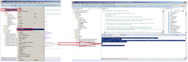

Build the Wireless uart project
Right Click on project folder and select Build Project as shown below:
Once it gets build you can see the status as Build Finished in console window

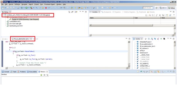

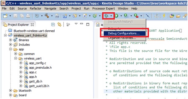

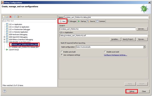

Click the “Debug” button to flash the executable onto the board
There are two project configurations (build targets) supported for each KSDK project:
Debug – Compiler optimization is set to low, and debug information is generated for the executable. This target should be selected for development and debug.
Release – Compiler optimization is set to high, and debug information is not generated. This target should be selected for final application deployment.
Choose the appropriate build target, "Debug" or "Release", by clicking the downward facing arrow next to the hammer icon, as shown below. For this example, select the "Debug" target.
Note: Please make sure that you install the latest J-Link driver and associate it with KDS. To do this, download the driver from https://www.segger.com/jlink-software.html and install it.
Connect your board-1  FRDM-KW41ZFRDM-KW41Z to your system and proceed to Debug configuration settings
The projects are configured to use “J-Link / J-Trace” as the default debugger. Please make sure that your board’s OpenSDA chip contains a J-Link firmware or that the debugger selection corresponds to the physical interface used to interface to the board.

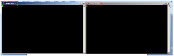

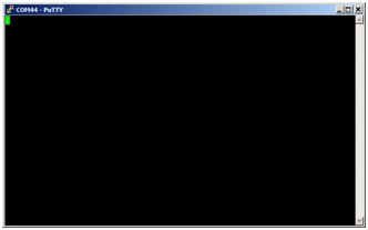

Open a putty or tera term hyperterminal application and open a session to your  FRDM-KW41ZFRDM-KW41Z COM port(in my case com port connected is to com44
Configure the terminal with these settings:
115200 baud rate
No parity
8 data bits
1 stop bit

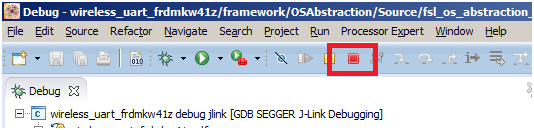

Start the application by clicking the "Resume" button:
You can see the execution of this board, the start Screen is blank after Resume is pressed
Now click on stop button as shown below:

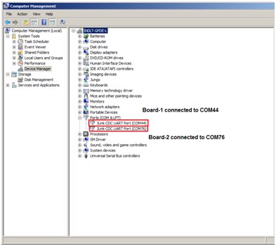

Now connect the board-2 KW41Z from different usb port, and you can see the two board com ports as shown below:
Now connect the board-2 and perform the same operation of executing the debugging activity so that the program is flashed to the second board (board-2).
The board-2 is connected to com76 port in this case

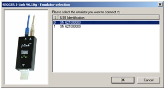

Select the second J-Link board which represents the board-2 connected as active debugging session for the tool:

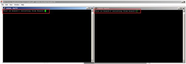

Open a hyperterminal with com76 port settings now you will be having 2 terminals open with wireless uart program executing on it.
Press the SW4 button on the first board to start scanning for devices.
Do the same on the second board.
After 3 seconds, the first board enters GAP General Discoverable Mode and the second board connects.
As soon as the LED3 turns solid on both devices, the user can start writing in one of the consoles.
The text appears on the other terminal, as shown in the figure below.
