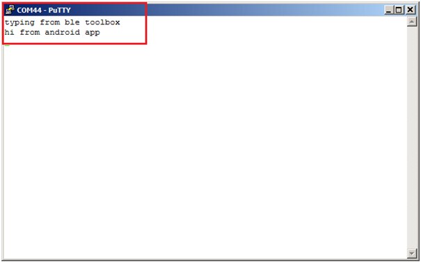

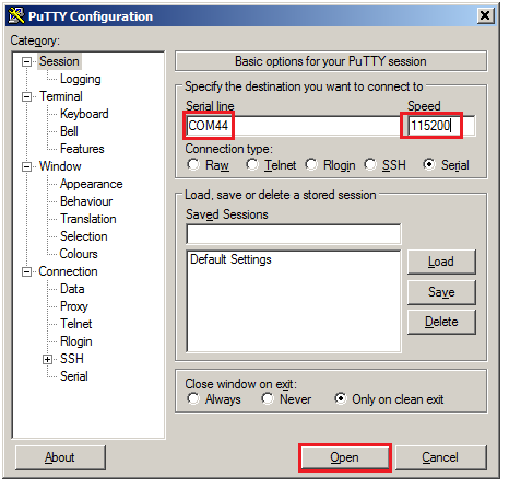

  • Open a serial port terminal and connect the board as shown below:
The start screen is blank after the board is reset

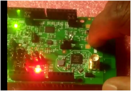

  • Press the SW4 button. After 5 seconds, the board enters GAP General Discoverable Mode and the Kinetis BLE Toolbox app can connect.

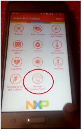

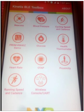

  • Open the kinetis BLE toolbox from your smart phone
Touch on Wireless console/uart

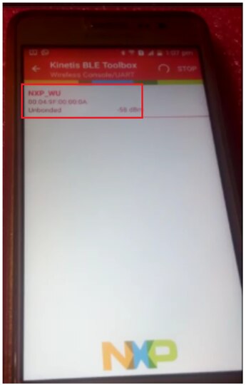

Your smart phone should detect the KW41Z NXP BLE board as shown below:

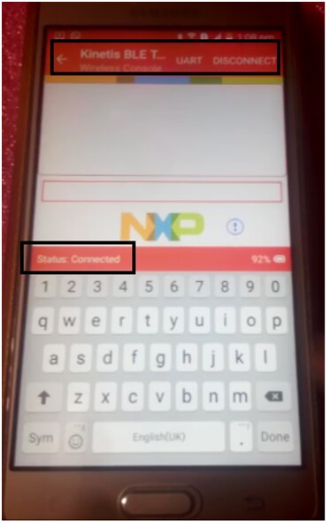

Touch on the NXP_WU to get connected, after getting connected your screen looks like:

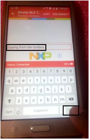

  • Now we can test the setup by typing the messages from smart phone or terminal window.
Typing the message on smartphone (press enter) the message gets displayed on KW41’s terminal window as shown here:

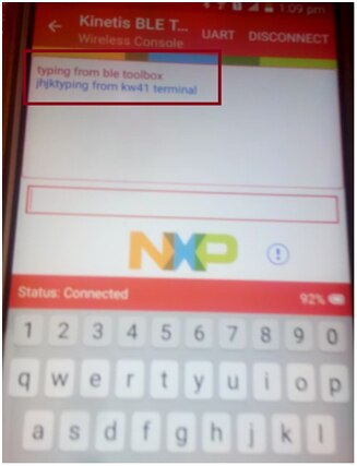

And the message typing from terminal window gets displayed on the smart phone screen as shown below:
