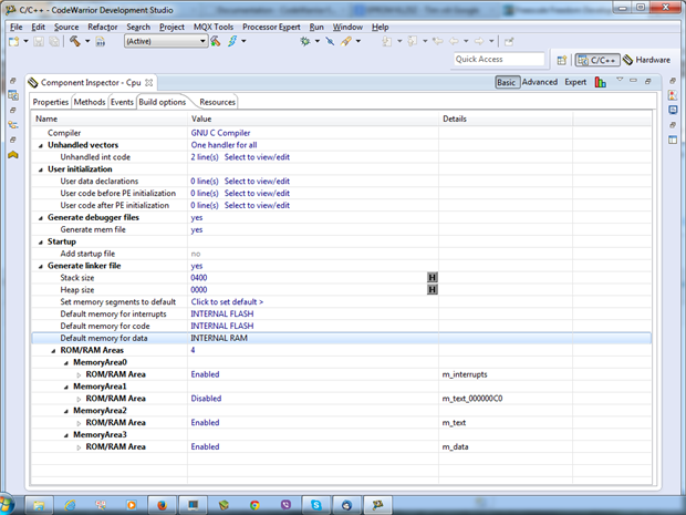

    QUESTION
    You are writing some datas to flash memory (eeprom emulation) using FRDM-KL25Z.
    You want to check what data you wrote (since you don't have LCD).
    Is there a way to check the data that you wrote using codewarrior IDE ?
    ANSWER
    You can use Processor Expert to read and write the flash:
    First, you have to reserve some Flash pages for data storage. Do that in the CPU Build Options, Reduce the Flash for code, for example :
    Then, configure those pages to be used by Flash component:
    Then, enable the Flash methods you need:
    Now, you can save the data in the code:

    e14 Contributor over 12 years ago in reply to FreescaleTools_and_Software
    I'm trying to create an emulation EEPROM for KL25Z-FRDM (using CW 10.5). But I can not find out the "Use user memory areas" selection to config Flash component.
