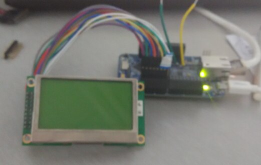

FRDM-K64F + KSDK SOFTWARE:How to light up a LCD screen display Chinese characters
e14 Contributor
The LCD panel model:LM6060CBY
I want to use the gpio port initialization LCD pin,but i don't know why is the LCD screen is couldn't show Chinese characters, don't know whether I drive call errors, hope everybody to help me look at it.
Below is the LCD initialization code:

    e14 Contributor over 11 years ago in reply to element14jamie
    I'm very sorry!I'll be careful next time。。。
  • clem57
    clem57 over 11 years ago in reply to e14 Contributor
    Ni Hoa http://www.element14.com/community/people/%E9%BB%A7%E9%BB%91%E4%B8%AD%E7%9A%84%E6%B5%81%E8%90%A4
       I speak a little Chinese. But as I understand LCD, they have built in Roman characters, but not Chinese characters. Therefore you would need to turn on dots and not use Display_ASCII(1,0,0x36,4,2);
    Clem
    e14 Contributor over 11 years ago in reply to clem57
    I thank you very much for your answer.According to you I tried again and found that the LCD panel will not show anything.
    The following figure, I want to initialize the use of the gpio port as 6060 LCD screen, call KSDK own gpio driver in software initialization and assignment of the pin, but don't know why I just can't show, don't know if I use gpio driver problem..

    Thank you very much for your help, I have already successfully solve the problem.image
  • clem57
    Can I ask what thw solution was? Glad to hear that things are better
    Yes.LCD can't display the reason is that drive current is not enough, not my mistake of program, and I put the external LCD screen of the VC to GND pin two other power supply to it, rather than from a pin power development board.
