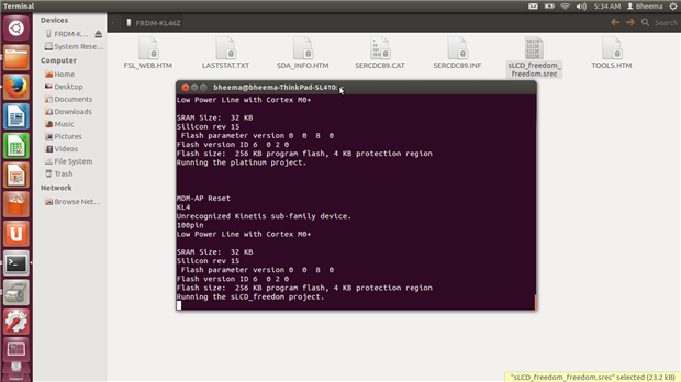

    Hi
    I tried serial communication with KL46Z board with the pre-compiled example downloading from below link:
    http://www.element14.com/community/docs/DOC-64227/l/freescale-precompiled-examples-for-frdm-kl46z-freedom-development-platform
    i flashed the LCD program in MSD program mode by copy pasting the "sLCD_freedom_freedom.srec" file to the "FRDM-KL46Z" folder detected from linux machine. i configured the serial terminal with "minicom" with baud rate of 115200, 8N1 and i could see the terminal working.
