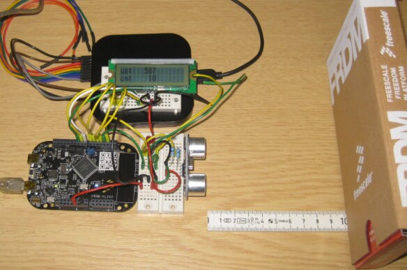

FRDM-KL25Z with HC-SR04
What I have added to my FRDM-KL25ZFRDM-KL25Z board is an ultrasonic distance sensor, measuring distances up to 4 meters.

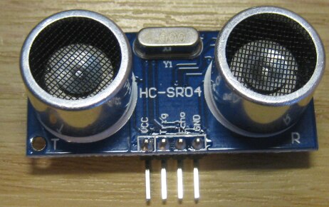

HC-SR04 Ultrasonic Sensor
The HC-SR04 sensor is a 4 pin sensor, at an incredible price point. I have mine from Play-Zone, but I have seen offers in the internet for around $6 too.
HC-SR04 Front Side

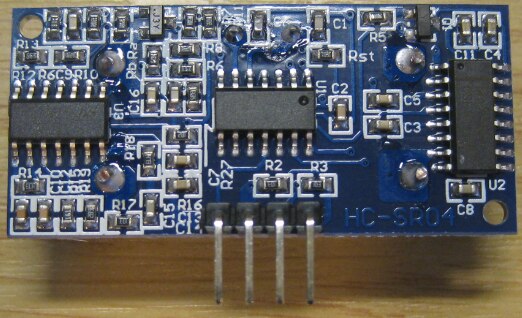

The backside features all the electronics to which simply usage of the sensor:
HC-SR04 Back Side
With simple I mean, it only needs 4 pins:
  1. Vcc (+5V DC supply)
  2. Trig (TTL input, to trigger a measurement)
  3. Echo (TTL output, pulse proportional to distance)
  4. GND (ground)

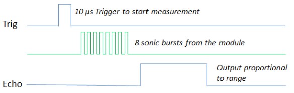

Using the sensor is simple:
HC-SR04 Timing Diagram
  1. Send a 10 us pulse on Trig
  2. In reaction to this, the sensor will send 8 sonic bursts to measure the distance
  3. After sending the burst, the sensor will raise the Echo signal until it receives the echo back. That means the length of the Echo signal corresponds to time the burst was travelling forward and echoed back.

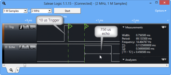

Below is a snapshot with a logic analyzer:
HC-SR04 Timing
After the 10 us Trigger signal, the sensor sends the burst during ’1′ and ’2′ (around 456 us), followed by the Echo signal duration of 756 us. The 756 us corresponds to the time it took for the burst to come back.
The speed of sound is about 340 m per second (depends on temperature and air relative humidity). A good approximation is 29 us per cm (or 58 us per centimeter as it is for back and forward). With the above example, the 756 us would result in 756/29/2 = 13 cm distance.

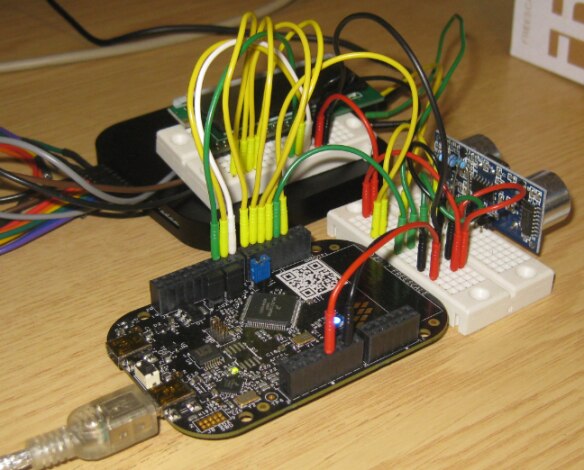

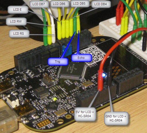

Hardware Connection
I’m using a breadboard for easy wiring and connection.
Breadboard Wiring with Freedom Board, Sensor, LCD and Logic analyzer
To visualize the measurement, I’m using the 2×16 Character display I have used in my earlier post. Of course a LCD is optional. I used the same wiring as before:
Signals with Labels
SIGNAL LIST
SIGNAL-NAME [DIR]        => PIN-NAME [PIN-NUMBER]
DB4_D4 [I/O]             => TSI0_CH5/PTA4/I2C1_SDA/TPM0_CH1/NMI_b [30]
DB5_D5 [I/O]             => PTA5/USB_CLKIN/TPM0_CH2 [31]
DB6_D6 [I/O]             => CMP0_IN2/PTC8/I2C0_SCL/TPM0_CH4 [65]
DB7_D7 [I/O]             => CMP0_IN3/PTC9/I2C0_SDA/TPM0_CH5 [66]
E_D10 [Output]           => PTD0/SPI0_PCS0/TPM0_CH0 [73]
LED_BLUE [Output]        => ADC0_SE5b/PTD1/SPI0_SCK/TPM0_CH1 [74]
LED_GREEN [Output]       => TSI0_CH12/PTB19/TPM2_CH1 [54]
LED_RED [Output]         => TSI0_CH11/PTB18/TPM2_CH0 [53]
RS_D8 [Output]           => PTA13/TPM1_CH1 [33]
RW_D9 [Output]           => ADC0_SE6b/PTD5/SPI1_SCK/UART2_TX/TPM0_CH5 [78]
US_Echo_D2 [Input]       => PTD4/LLWU_P14/SPI1_PCS0/UART2_RX/TPM0_CH4 [77]
US_Trig_D3 [Output]      => PTA12/TPM1_CH0 [32]

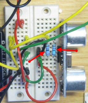

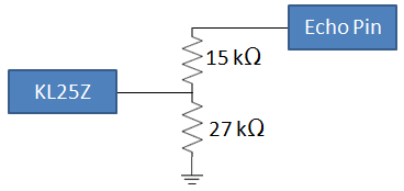

What I need is the supply voltage, ground, an output pin (Trig) and an input pin to measure the signal (Echo).
The HC-SR04 uses TTL (5V) supply voltage and logic levels. The FRDM-KL25Z processor is a 3.3V one, but the board provides 5V on the header. The HC-SR04 can use 3.3V levels on the Trig signal, but provides a 5V signal on the Echo pin. To get the signal to the 3.3V level, I use a simple voltage divider with a 27k Ohm and 15k Ohm resistor:
Voltage Divider with two resistors
Voltage Divider Detail

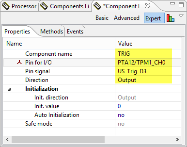

Trigger
For the Trigger pin I add a BitIO_LDD component to my project:
BitIO_LDD Component
I configure it as Output pin on PTA12:
Trigger Properties

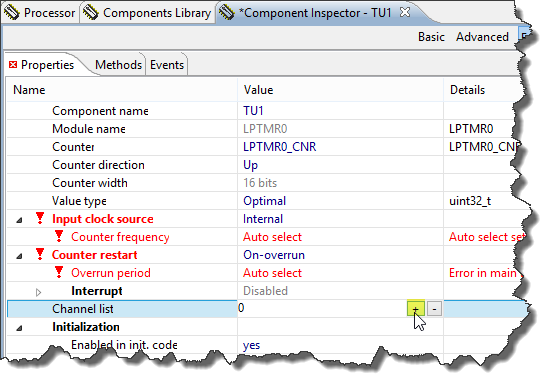

Echo Pulse Measurement

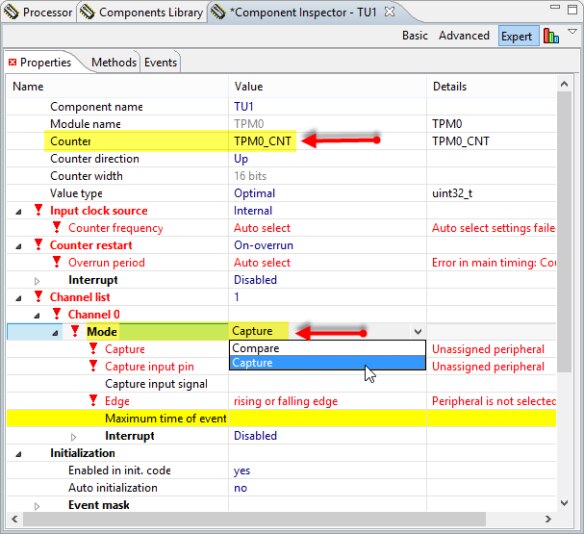

To measure the echo, I add a TimerUnit_LDD component:
TimerUnit_LDD added
That component shows errors for now, because I need to configure it for my needs. What I want is a timer measuring the echo signal. For this I need to set up a timer which starts counting on the echo raising edge, and stops at the falling edge. For this I need a timer channel.
I add a new channel using the ‘+’ icon:
Adding Timer Unit Channel

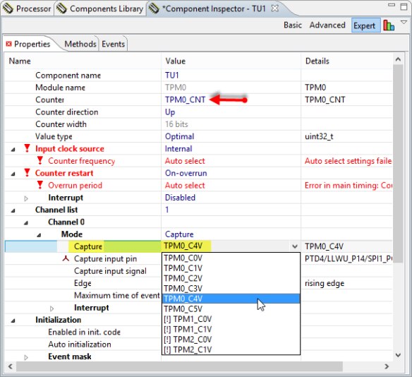

For this I’m selecting the TPM0_CNT as counter and configure the channel for ‘capture’:
:idea: You will understand later on why I have selected this particular counter.

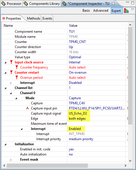

Using TPM0_CNT and Capture Mode

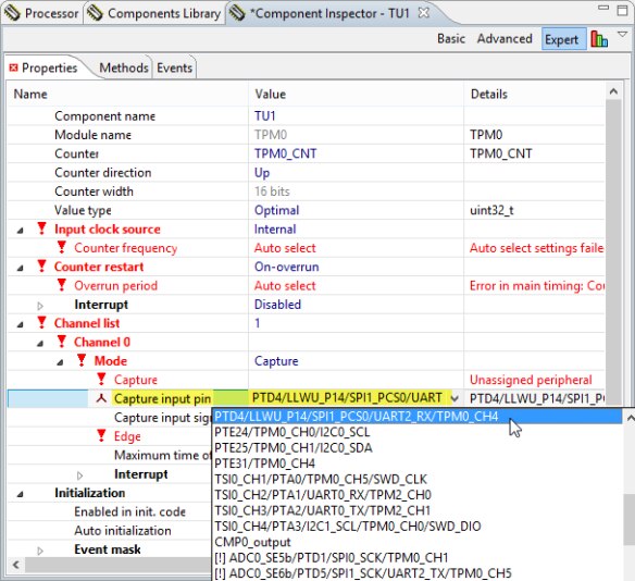

As I have connected the Echo signal on PTD4, I need to use that pin as ‘Capture input pin’:
PTD4 as input capture pin
As hinted by the pin name (PTD4/LLWU_P14/SPI1_PCS0/UART2_RX/TPM0_CH4), this pin is available on TPM0_CH4, so I need to configure this as capture device:
selected capture device
:idea:  Now you see why I have selected TPM0_CNT above as Counter device. I admit: that’s not something easy to know about, because this KL25Z has mirades of pin and mapping configuration (called Pin Muxing) :-( . One way is to guess what is behind from the pin names (this is what I try first). Otherwise you need to read through the device reference manual (which is very time-consuming). I wish these devices would be much less complicated and easier to use….

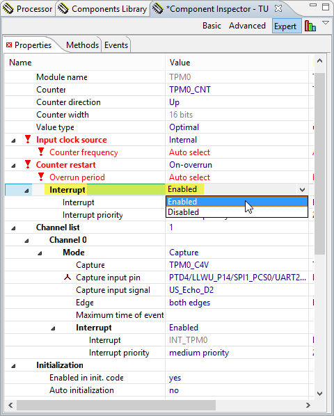

I want to get an interrupt for both the raising edge and falling edge of the Echo signal: I enable interrupts and configure it for both edges. And I give the signal a nice name:
Interrupt Settings
That’s not enough: I need to enable interrupts for the counter too:
Enabled Interrupts for Counter

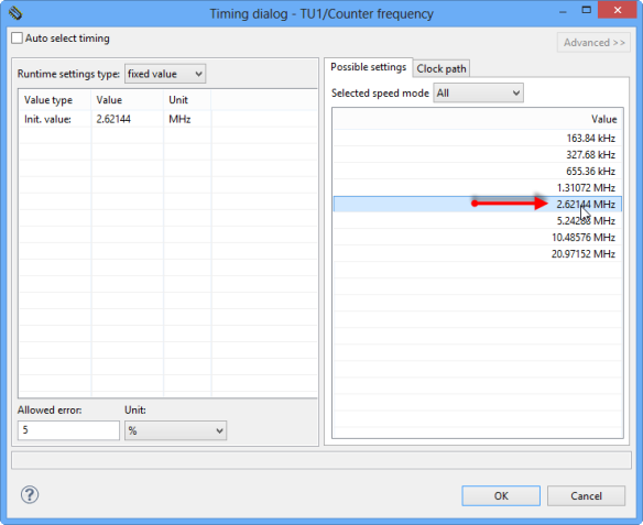

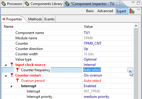

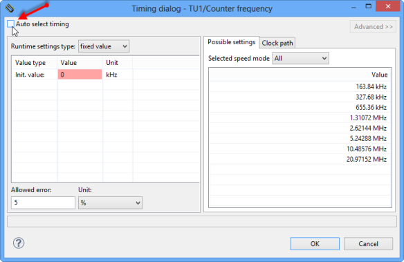

Counter Frequency
I still have errors showing up for my Timer/Counter: I need to configure the counter frequency: This is the clock which is used for my counter. In principle: the higher the frequency, the more precise the measurement will be. As always: a good balance is required. First, I configure the counter frequency:
Configuring the counter frequency
The first thing to do is to disable ‘Auto select timing’:
Disabling Auto Select timing
:idea: Processor Expert usually chooses good default values, but fails (for whatever reason?) to do this properly for timers on the ARM platform. So as solution I always disable auto-select-timing and explicitly make my choice. Maybe better that way anyway :-)
I make a gut guess and select a 2.x MHz clock from the list (double-click to assign it):
Selected clock frequency

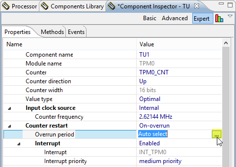

Counter Overrun
There one thing to consider: when will the counter overflow? I keep in mind that with the speed of sound, around 4 meters distance means 400*58us makes 23.5ms Echo signal pulse. So I need to make sure that for this distance, my counter does *not* overflow. I can check this in the ‘Overrun period’ settings:
Overrun period
Deselecting ‘auto select timing’ again will show the overrun period time:
Overrun period
So my timer will overrun after 25 ms, so I’m fine :-)

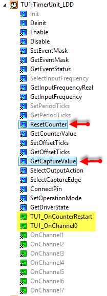

Next, I need to enable two methods I want to use. I need to read the counter value, and I need to reset it. As such, I enable the two methods (right-click on the method name and select ‘Toggle Enable/Disable’):
Enabled TimerUnit_LDD Methods
I notice the two events called:
  • OnCounterRestart() is called when there is a restart/overflow of the counter
  • OnChannel() is called for every interrupt of my channel. Remember that I have it configured for creating an interrupt/event for both raising and falling edge.

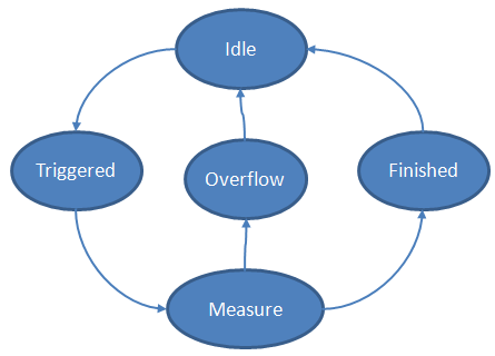

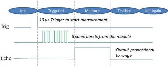

State Machine
I’m using a state machine to go through the different measurement phases:
State Diagram
  • Idle: Sensor is idle
  • Triggered: we sent the trigger signal to the sensor
  • Measure: we received raising edge of echo signal and are measuring
  • Overflow: Counter overflow happened (see above)
  • Finished: received falling echo signal edge and we have captured the echo signal time
Another way is to show the different states on the timing diagram (without the Overflow case):
Timing and State Diagram

It sends the 10 us trigger and then waits for the finished state. In case of overflow (no echo received), I simply return a value of zero.
The function returns the measured echo time in microseconds. To deal with different timer frequencies, the macro TU1_CNT_INP_FREQ_U_0 is used which is generated by Processor Expert.
Calculating to Distance
