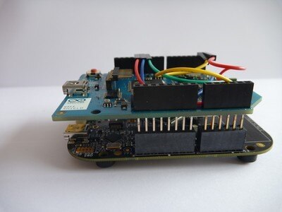

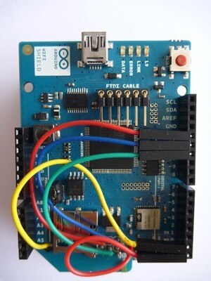

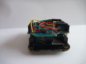

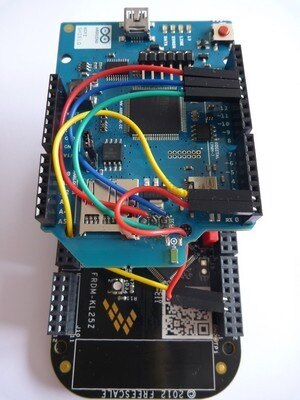

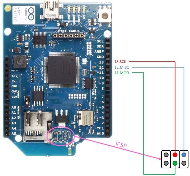

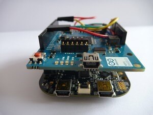

Hardware modifications

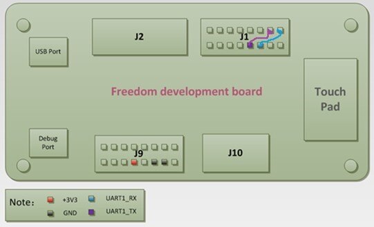

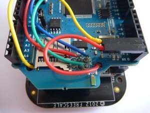

Since the Digital interface and ICSP interface are not connected together on the Arduino Wi-Fi Shield, you need to connect them manually as shown in the figure below.
Then you must connect UART1 with UART0 via jumper wires.
Note : In current version driver, the Wi-Fi Shield configuration uses the serial port UART1_TX and UART1_RX.

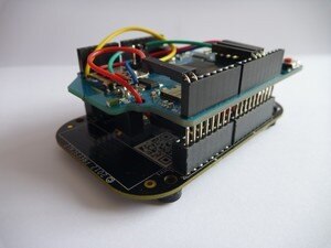

So finally your FRDM-KL25Z_WIFI kit should look like as below

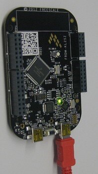

This demo has already been precompiled so you can simply download the hexadecimal file "Coocox Wifi Arduino Demo v2.0beta.srec" and program it in flash thanks to the OpenSDA MSD Application.
1. Keep pressing the reset button while plugging the USB cable in the OpenSDA port of the Freescale FRDM-KL25z board
2. Release the Reset button ... A new drive "BOOTLOADER" will appear in Windows Explorer
3. Drag'n drop or Copy-paste the OpenSDA application file "MSD-FRDM-KL25Z_Pemicro_v107.SDA" in the BOOTLOADER drive in Windows Explorer
3. Unplug and replug the USB cable ... A new drive "frdm-kl25z" will appear in Windows Explorer and a new peripheral OpenSDA -CDC Serial Port (COM15) will be detected in Device Manager
4. Drag'n drop / copy-paste the file "Coocox Wifi Arduino Demo v2.0beta.srec" in the frdm-kl25z drive in Windows Explorer
