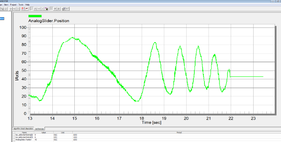

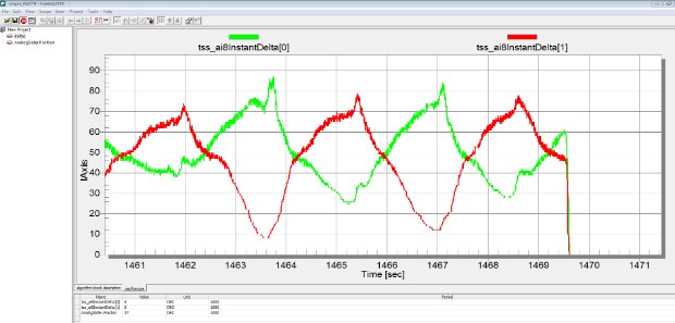

The visualization output has 2 separate scope windows:
  • one showing signals captured from electrodes of slider
  • another one showing position of finger on a slider

There are two independent snapshots below, showing the response to my finger movement along the slider
