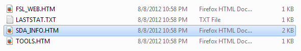

  3. The board will enumerate as BOOTLOADER

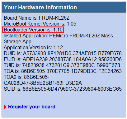

  4. Explore the new drive, and double click on SDA_INFO.HTM to see your current firmware revision.
  5. You can see in this example, the bootloader firmware version is 1.10
