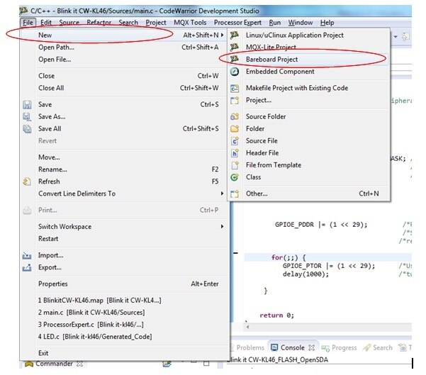

Select File->New->Bareboard Project

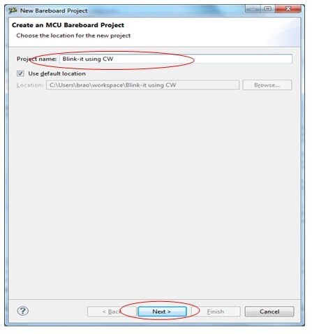

Provide Project Name “Blink-it using CW” then click Next

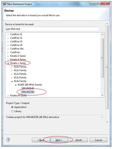

Now select the MCU exist on our KL46 board it is “MKL46Z256”
Kinetis L Series-> KL4x Family->KL46Z(48 MHz) Family->MKL46Z256   then Click Next.

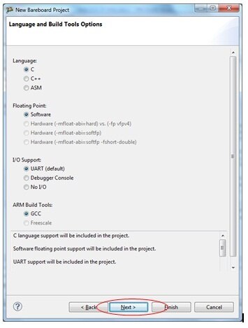

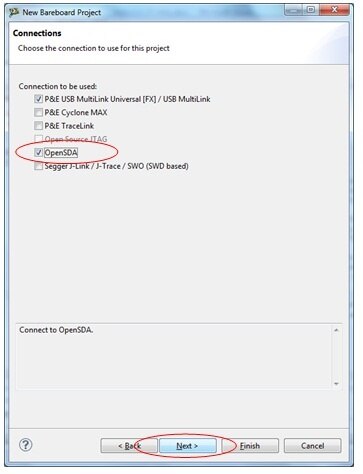

Select OpenSDA option to connect for this board for debugging and programming, then click Next
Then click Next to proceed further
proceed further by clicking Next

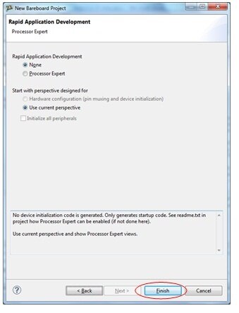

in Rapid application development do not select Processor Expert then click on finish.

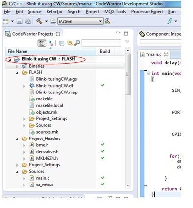

I have created the project by name “Blink-it using CW” as shown below:

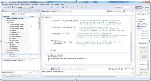

Now open “main.c” and add the below code to it.
#include"derivative.h"/* include peripheral declarations */
void delay(int itime);
int main(void)
SIM_SCGC5 |= SIM_SCGC5_PORTE_MASK;
PORTE_PCR29 = PORT_PCR_MUX(1);
           GPIOE_PDDR |= (1 << 29);
          for(;;) {
             GPIOE_PTOR |= (1 << 29);
             delay(1000);
       return 0;
void delay(int itime){
   int icompTime = 0;
   for(icompTime=itime*1000;icompTime!=0;icompTime--){
The line of code shown below is System Clock Gating Control Register 5 (SIM_SCGC5)and Enable clock for PORT E setting bit field PORTE
Next below line is Pin Control Register n (PORTx_PCRn) setting for PORTE, and Select GPIO as pin functionality on multiplexer setting field MUX=001
The below line of code is Port Data Direction Register (GPIOx_PDDR) and Set GPIO direction set bit corresponding bit on the direction register for each port, set the bit means OUTPUT
In for() loop we are toggling the output LED connected to PortE29
This can be found from Schematic of KL46Z board (http://www.element14.com/community/docs/DOC-54780/l/element14-presents-the-frdm-kl46z--a-freescale-kinetis-l-based-freedom-development-platform)
LED
KL46
Green (LED1)
PTD5
Red (LED2)
PTE29

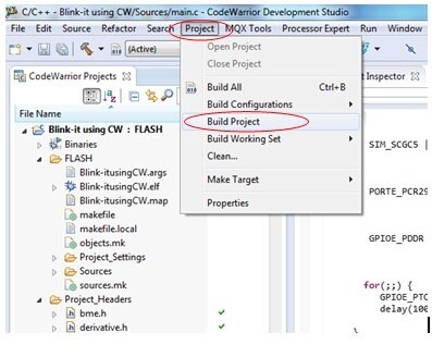

Now it’s time to clean and Build the project as shown:

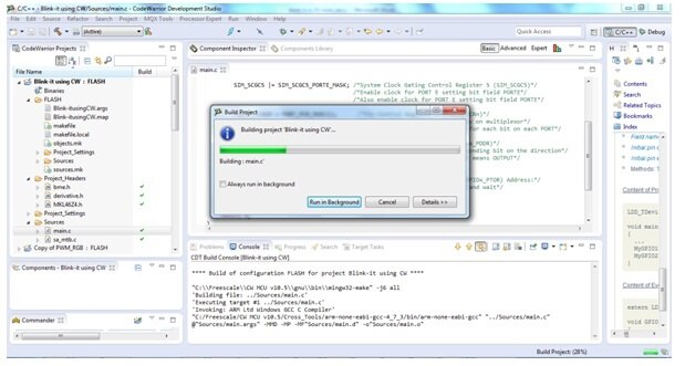

You can then see project starts building as shown

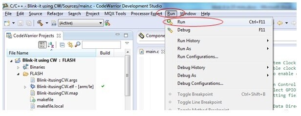

Now Run the project as shown:
Now you can see the blinking of Red LED on KL46 board
