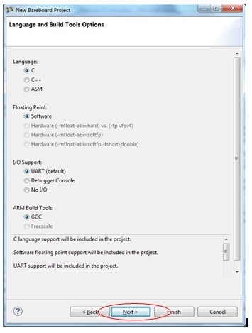

Follow the below steps for creating the CW project:

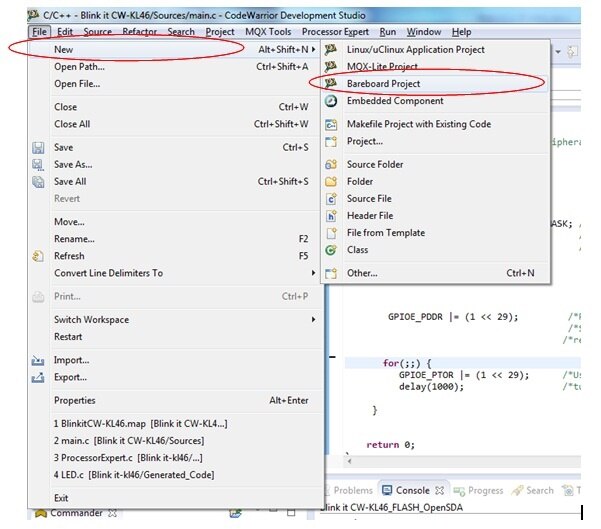

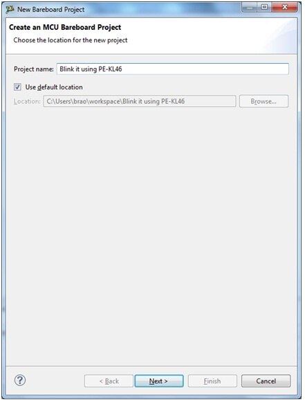

Select File->New->Bareboard Project
Provide Project Name “Blink it using PE-KL46” then click Next

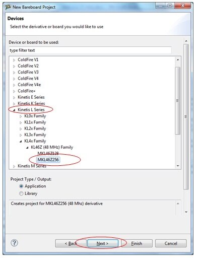

Now select the MCU exist on our KL46 board it is “MKL46Z256”
  Kinetis L Series-> KL4x Family->KL46Z(48 MHz) Family->MKL46Z256

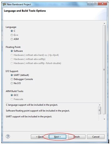

  then Click Next

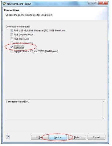

Select OpenSDA option to connect for this board for debugging and programming, then click Next
Then click Next to proceed further

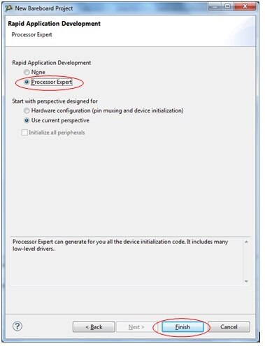

Select ‘Processor Expert’ option as we are creating the project using Processor Expert then click ‘Finish’

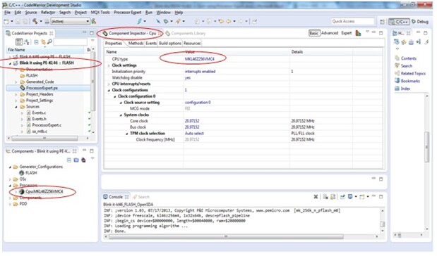

I have created the project by name “Blink it using PE-KL46” as shown below are the component inspector showing CPU with default settings:

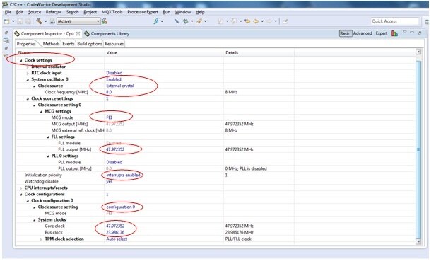

First we need to configure CPU parameter settings as shown below:
Under clock Settings->
System Oscillator: Enabled
Clock Source: External Oscillator
Clock Frequency: 8 MHz (as this board is connected to external crystal oscillator )
Under clock source settings-> clock source settings 0-> MCG settings->
MCG mode: FEI (FLL engaged internal)
FLL settings->FLL output[MHz] : 47.972352
Then automatically MCG output[MHz] gets selected to 47.972352
Then under Clock configurations->Clock configuration 0->System clocks->
Set
Core clock: 47.972352 MHz
Bus clock: 23.986176 MHz
Then all other parameters which were highlighted in RED gets cleared which means the settings are correct. These settings are as shown in above figure.

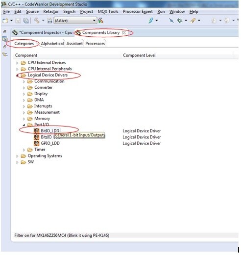

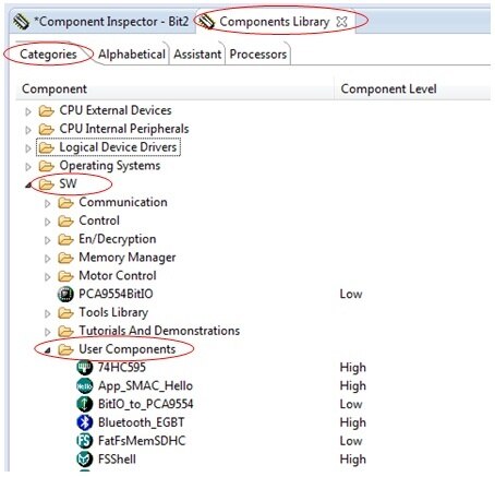

Now select under Component Library-> categories sub window
Click on Logical Device Drivers->Port I/O-> BitIO_LDD
Right click and select ‘Add to Project’ twice since we need two LED component in our project.

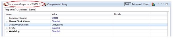

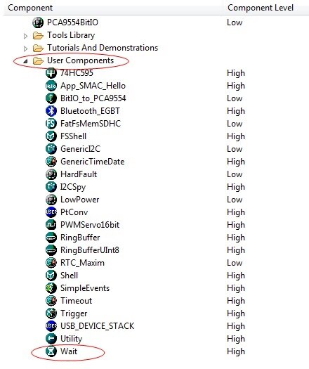

Now we are adding software generated ‘wait’ component in order to add delay routine to our project.
Under Component Library-> categories sub window
Click on SW->User Components->Wait component, Right click and select ‘Add to Project’

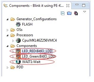

Rename the components (LED_RED, LED_Green, WAIT1)as shown below:

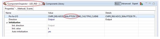

Make the ‘LED_RED’ BitIO settings as shown below: assigned to output pin ‘PTE29’

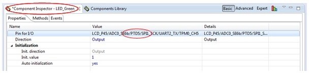

Make the ‘LED_Green’ BitIO settings as shown below: assigned to output pin ‘PTD5’

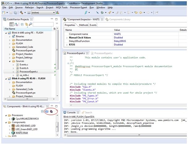

And default settings for ‘Wait1’ component as shown below:

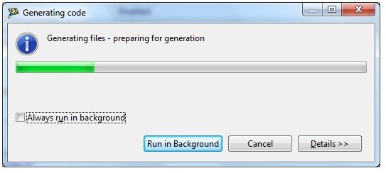

Now click on ‘Generate Processor Expert code’ radio button as shown below:

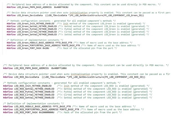

You can see the tool generates required code as shown below:

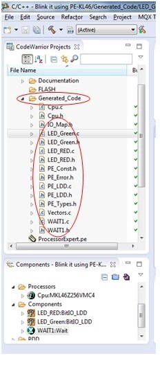

All the required header files will get generated under ‘Generated_Code’ folder as shown below:

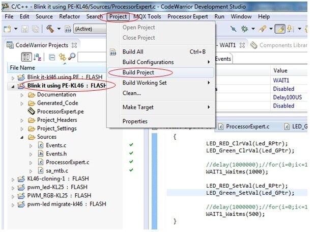

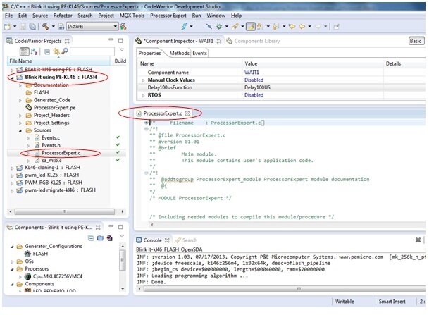

Now select ‘ProcessorExpert.c’ from project window
Add below lines of code in ‘ProcessorExpert.c’ file

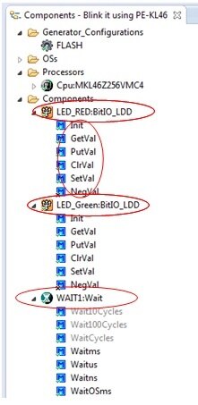

The functions related to LED_RED, LED_Green can be explored from the Generated code folder in “LED_RED.c”, “LED_Green.c” and defined in LED_RED.h, LED_Green.h files as shown below:
Its functions can also be seen from components window as shown:

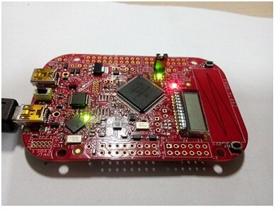

As per the code instruction we are turning on LED for 1000 ms and turning off the LED’s for 500 ms and looping forever.

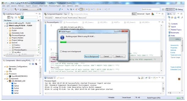

Now it’s time to clean and Build the project as shown:
You can then see project starts building as shown:

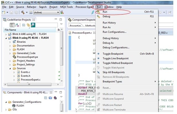

Now Run the project as shown:
Now you can see the blinking of Red and Green LED on KL46 board
