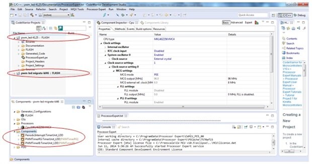

Now let’s start on migrating the available sample code of KL25Z, I have selected the “pwm_led” project which is located in folder “~\Downloads\KL25 Sample Code\kl25_sc_rev10\klxx-sc-pex\projects\pwm_led\cw”
Open this project in code warrior in current workspace (you can drag and drop the “.project” present in pwm_led project folder).
I have rename the project as “pwm_led-KL25” and saved a copy in my current workspace to differentiate the original one.

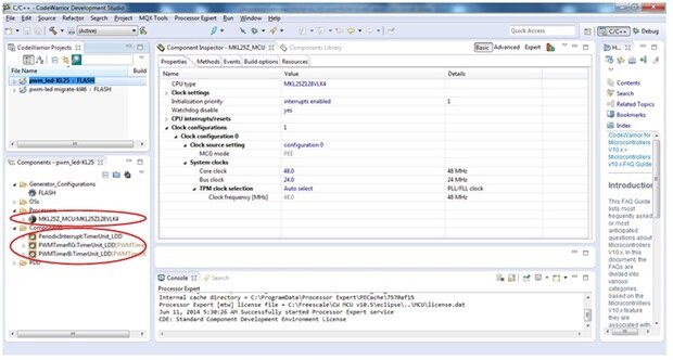

You can see from above snap shot i have opened the project it has kinetis family MCU ‘MKL25Z128VLK4’ running at 8 MHz connected to external crystal, PEE(PLL engaged external) as MCG mode and core clock is 48 MHz, Bus clock is 24 MHz.
The components present in this project are module "PeriodicInterrupt" (component TimerUnit_LDD), Module "PWMTimerRG" (component name ‘PWMTimerRG’ of type TimerUnit_LDD ), and Module "PWMTimerB" (component name PWMTimerB of type TimerUnit_LDD).

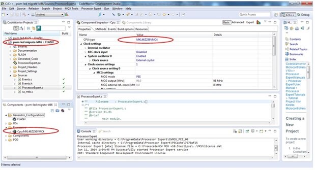

  I have created the project by name “pwm-led migrate-kl46” as shown below is the component inspector showing CPU with default settings:

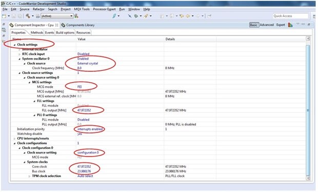

First we need to configure CPU parameter settings as shown below:
Under clock Settings->
System Oscillator: Enabled
Clock Source: External Oscillator
Clock Frequency: 8 MHz (as this board is connected to external crystal oscillator )
Under clock source settings-> clock source settings 0-> MCG settings->
MCG mode: FEI (FLL engaged internal)
FLL settings->FLL output[MHz] : 47.972352
Then automatically MCG output[MHz] gets selected to 47.972352
Then under Clock configurations->Clock configuration 0->System clocks->
Set
Core clock: 47.972352 MHz
Bus clock: 23.986176 MHz
Then all other parameters which were highlighted in RED gets cleared which means the settings are correct. These settings are as shown in above figure.
Since now our project skeleton is ready (i.e no component module peripherals has been added to our project) we need to add the required peripheral component module as per our requirement.

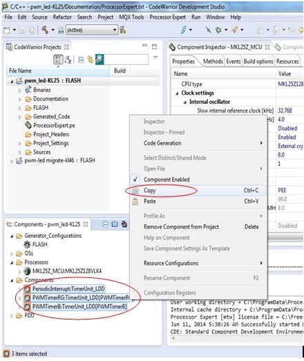

Copy all the three components present in KL25Z project as shown:
Paste the copied 3 components to our created project folder “pwm-led migrate-kl46” under ‘Components’ window as shown below:

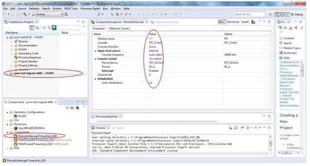

Now select the first component ‘PeriodicInterrupt’ and change the settings as shown:
This is a Periodic interrupt timer module with counter direction as Down count, it uses internal clock source of 24 MHz as counter frequency. Make sure the interrupt is enabled and the period of the counter is set to 50 us (i.e this PIT will generate an interrupt on every 50us)

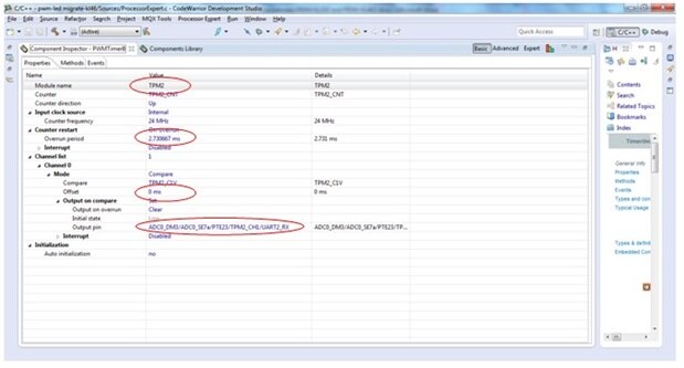

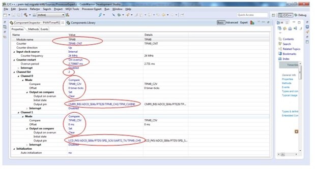

The second component is “PWMTimerRG” of type “TimerUnit_LDD” which is connected to RED and GREEN LED of KL25Z board its setting are as shown below:
This module is connected to TPM0 Flex Timer Module which runs in ‘UP” counter direction with period of 2.7306 ms with its interrupt disabled.
Further to this timer module we are taking 2 outputs by connecting them to two channels, one is connected to channel-2 (TPM0_C2) of timer module which leads to o/p port pin PTE29 and another connected to channel-5 (TPM0_C5) of timer module which in turn connects to PTD5 port pin.
We have selected these channel output port pins because the physical LED’s are connected in the board to particular GPIO pins i.e
  Refer to below schematic there are two LED’s exist on board Red and Green connected to Port-E 29th bit (PTE29) and Port-D 5th bit (PTD5).
LED
KL46
Green (LED1)
PTD5
Red (LED2)
PTE29
We should run this timer as PWM to do so it has to run in ‘compare’ mode. As this module is 16 bit timer running counts from 0000 to FFFF (0 to 65535 timer-ticks) and  initial offset is given as ‘0’ timer-ticks so that the PWM starts from 0% of dutycycle. We access this ‘offset’ variable during programming and continuously change its value varying the duty cycle to 100%.

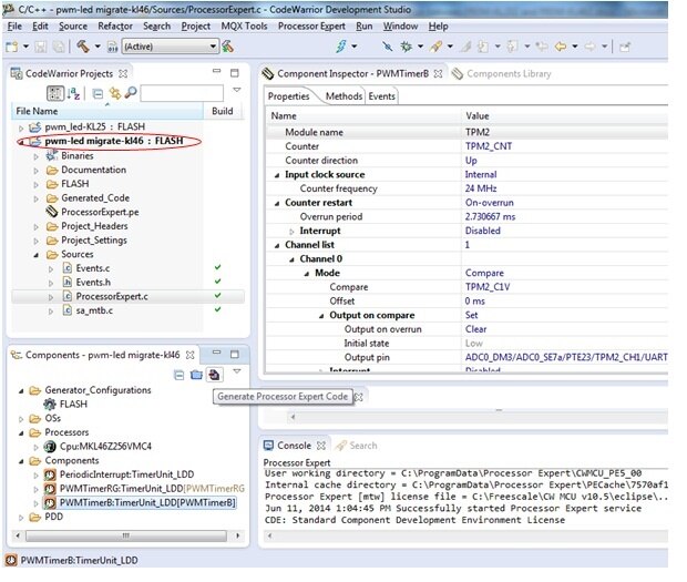

Next coming to third module “PWMTimerB” it is connected to ‘Blue’ LED in KL25Z board we need to connect this manually in case of KL46Z board and we are connecting it to PTE23 port pin which internal connected to TPM2- channel-1, its period is 2.7306 ms and ‘offset’ is set to ‘0’.

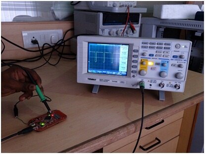

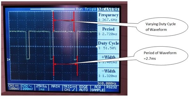

The PWM waveform will look like the below picture:

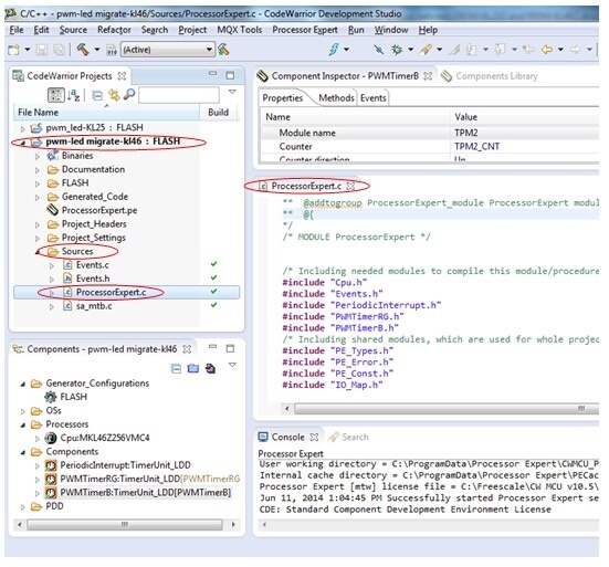

Now it’s time for us to write our application code, since RGB LED is not present in KL46Z board i am going to write my own application where i will be varying the brightness of LED present in KL46Z (i.e Red and Green) through varying the PWM duty cycle.
The place where i need to write my code is file “ProcessorExpert.c” located in ‘sources’ folder in my project folder which is shown in below picture.
Since we are writing fresh lines of code i delete all its content by pressing Ctrl-A and Delete then paste below line of code.

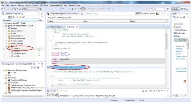

As mentioned earlier the Periodic interrupt timer module will be generating an interrupt for every 50 us we need to create a variable “PeriodicEvent” as shown below in the file “Events.c”
  extern volatile bool PeriodicEvent;
Add below lines of code inside a function as shown
“void PeriodicInterrupt_OnCounterRestart(LDD_TUserData *UserDataPtr)”
  /* Write your code here ... */
       PeriodicEvent = TRUE;

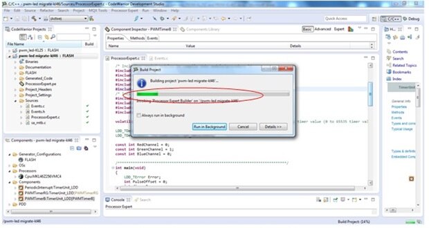

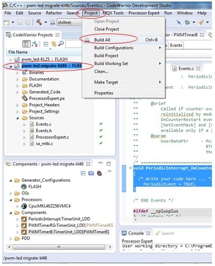

Save all the files then clean and Build the project as shown below:
The build progress is shown below:

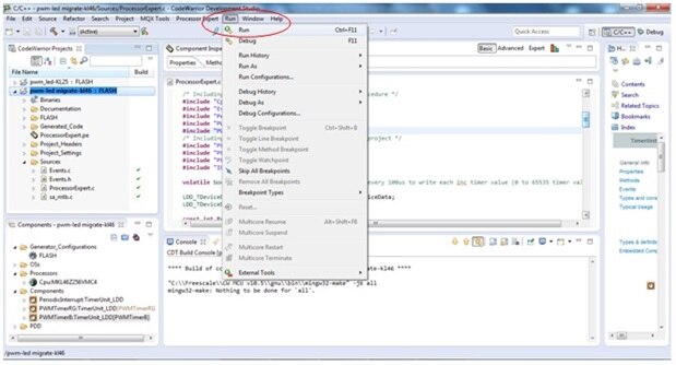

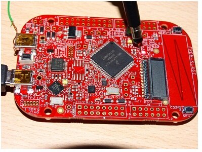

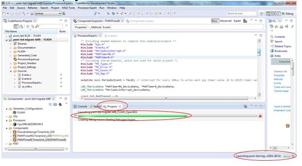

Now connect the board to USB through OpenSDA port of the board and Run the project as shown below:
You can see Run progress bar as shown below:

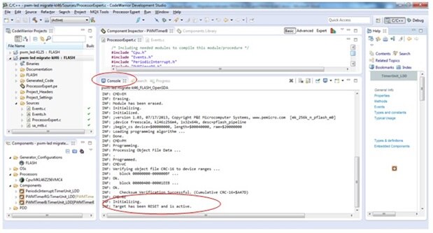

Below is the console window which shows the status of execution process
You can see the output which shows 2 LED’s Red and Green intensity is increased from 0% to 100% and again coming back from 100% to 0%. You can see the output waveform on CRO by connecting at led terminal as shown:
The output waveform seen through oscilloscope is as shown below along with setup:
Watch the video output which is attached in this blog. Created supporting project files have been enclosed too for quick reference.
So it is concluded that by using the processor expert migration of the project from different Freedom platform boards made easy.
Happy Migrating ..... image image
