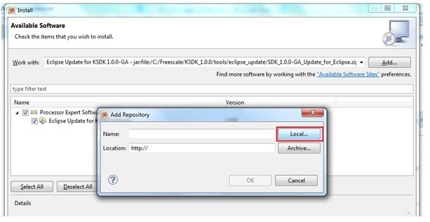

This document will show how to install New Eclipse Update required to work on recent SDK 1.0.0-GA.
Without the update, KDS cannot generate KSDK-compatible projects.
To use the Kinetis SDK with Eclipse and Processor Expert, this updated needs to be installed into Eclipse (e.g. Kinetis Design Studio or Processor Expert Driver Suite). Otherwise both 'New Project Wizard' and Processor Expert will not know about the devices present and supported in the Kinetis SDK.
With the installation of this update, the 'New Project Wizard' will be enabled to use the Kinetis SDK for the devices supported, and Processor Expert components for the Kinetis SDK are added.

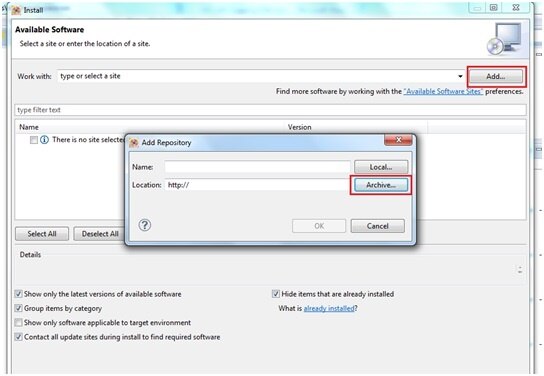

To install the update, follow these instructions:

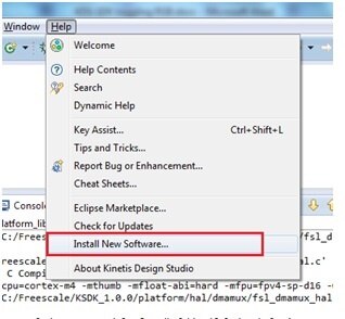

In a KDS project window Select Help > Install New Software.
In the “Install New Software” dialog box, select the “Add…” button in the upper right corner.
Select “Archive…” In the “Add Repository” dialog as shown below.
Or optionally you can download the KSDK update from here Freescale Kinetis SDK_1.0.0 - Windows installer and provide the local path in “Add Repository” window.

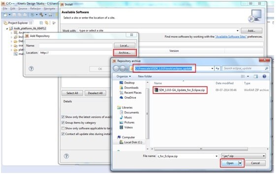

In the dialog box that appears, browse the KSDK install directory. From the top-level, enter the tools/eclipse_update folder and select the SDK_1.0.0-GA_Update_for_Eclipse.zip file as shown below.

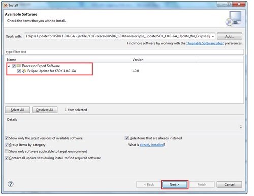

Click on “Open”, and then “OK” in the “Add Repository” dialog box. The KSDK update now shows up as “Processor Expert Software” >“Eclipse Update for KSDK 1.0.0-GA” as shown below.
Check the box to the left of the KSDK Eclipse update and click “Next” in the lower right corner. Follow the remaining instructions to finish the installation of the update.
Once the update is applied, restart KDS for the changes to take effect.

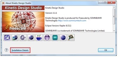

Click on Help> About Kinetis Design Studio

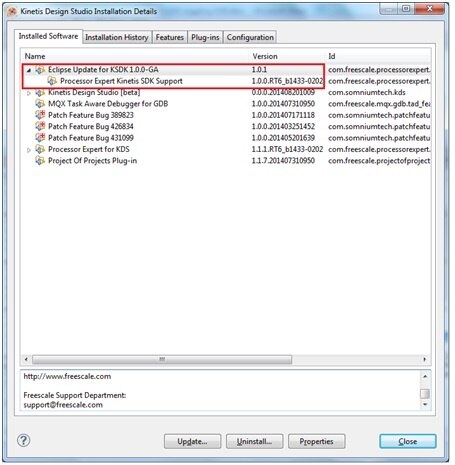

And click on installation details as shown below:
You can see all the updates installed check Eclipse Update for KSDK 1.0.0-GA is installed as shown

    bheemarao over 11 years ago in reply to clem57 +1
    Yes it is required with out this update SDK projects are not supported. Refer to "Kinetis Design Studio Release Note" under 'Using Kinetis Design Studio with the Kinetis SDK ' it has been mentioned The…
  • clem57
    clem57 over 11 years ago in reply to bheemarao
    Thank you for clarifying
  • bheemarao
    Refer to "Kinetis Design Studio Release Note" under 'Using Kinetis Design Studio with the Kinetis SDK ' it has been mentioned The Kinetis SDK comes with support for the Kinetis Design Studio which needs to be installed first. Without the Kinetis SDK Eclipse Update Files into the Kinetis Design Studio, the Kinetis SDK projects are not supported.
  • clem57
    Will this be needed on a fresh install?
