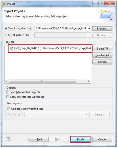

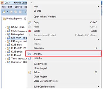

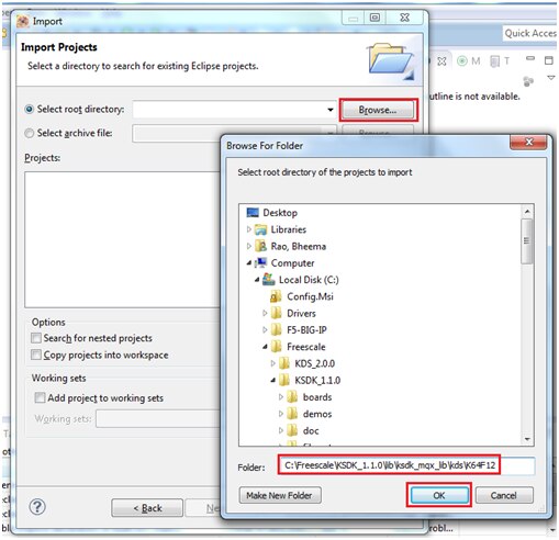

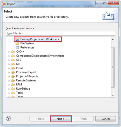

Right click on project explorer and select import as shown below:
Select existing project into workspace as shown below
Next browse to the installed KSDK folder as shown below:
The folder path in my case is   “C:\Freescale\KSDK_1.1.0\lib\ksdk_mqx_lib\kds\K64F12”
Proceed further by clicking finish

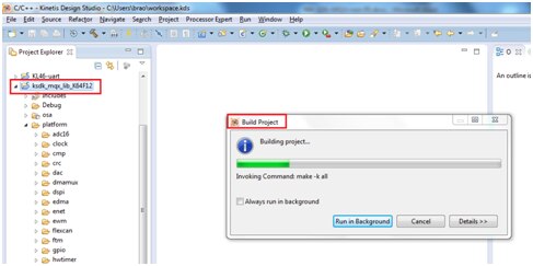

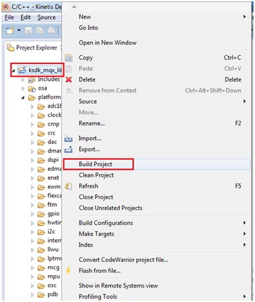

Now select the project from project explorer and build the library as shown below:

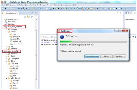

You can see the project build progress as shown below:

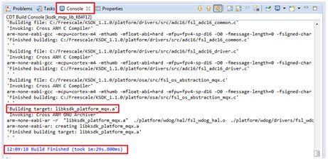

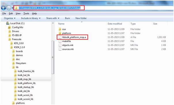

You can see the generated library file “libksdk_platform_mqx.a” under console window as shown below:
The path it is generated is “C:\Freescale\KSDK_1.1.0\lib\ksdk_mqx_lib\kds\K64F12\Debug”
Note: remember this path which has to be provided for any new MQX project creation.

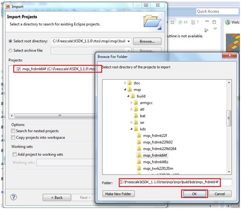

2) MQX Library, ‘lib_mqx.a’
Follow the similar steps as above the path while importing for lib_mqx is
“C:\Freescale\KSDK_1.1.0\rtos\mqx\mqx\build\kds\mqx_frdmk64f”
Build the project “mqx_frdmk64f”
The library generated file is “lib_mqx.a” which is stored in path
“C:\Freescale\KSDK_1.1.0\rtos\mqx\lib\frdmk64f.kds\debug\mqx”

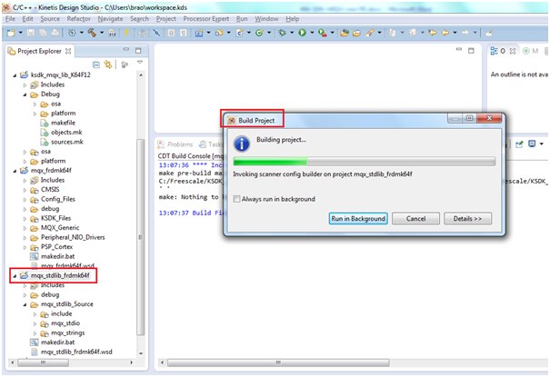

3) MQX Standard Library, ‘lib_mqx_stdlib.a’
Similarly import “mqx_stdlib_frdmk64f” project from the folder
“C:\Freescale\KSDK_1.1.0\rtos\mqx\mqx_stdlib\build\kds\mqx_stdlib_frdmk64f”
  And build it as shown below:
you will find the generated library “lib_mqx_stdlib.a” stored at location
"C:\Freescale\KSDK_1.1.0\rtos\mqx\lib\frdmk64f.kds\debug\mqx_stdlib"
Note: remember these paths to be included at the time of any new MQX project building and execution.
