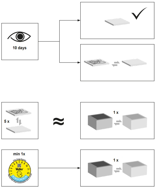

    yes:
    Manual says to check the pre-filter every 10 days, and replace if dirty
    After 5 replacements, the main HEPA filter should be changed
    In any case, that HEPA filter should be replaced every year.
