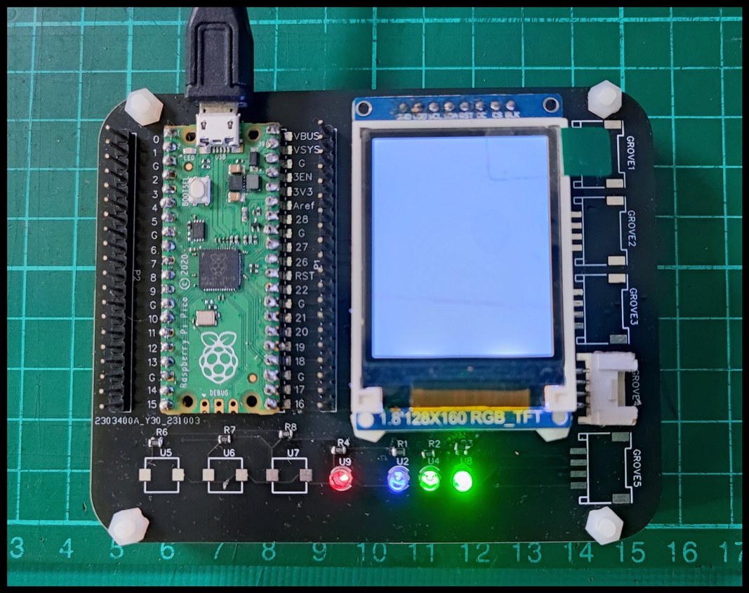

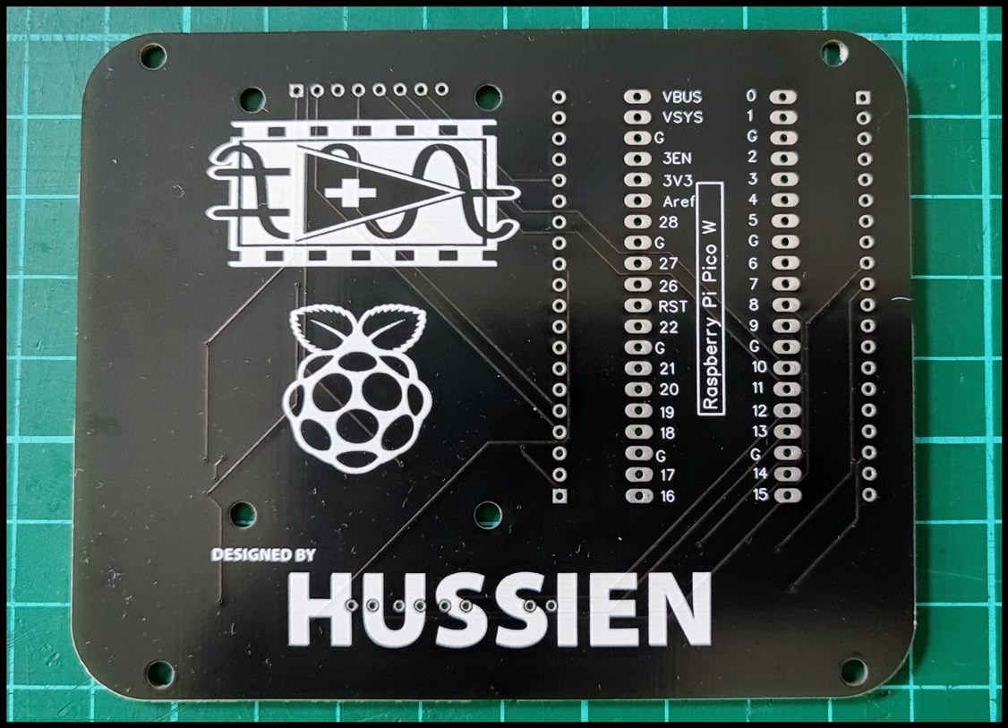

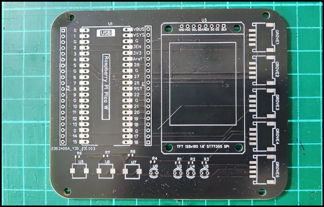

For the hardware part, obviously, I am using the Raspberry Pi Pico. On top of that, since I am building an automated plant watering system, I will be using the soil moisture sensor to get the soil moisture value and the relay to control the water pump. Since the beginning of the project, I have been excited about having a specific board that can be used as an interface for this project. Hence I decided to build one. The figure below shows the image of the board.
This board basically has a TFT 1.8" display, 4 grove ports, 3 indicator LEDs and 3 push buttons. Unfortunately, later I came to know the pin output does not tally with the SCPI lab tool. However, I am still able to access the other pin through the pin header. The image below shows the component populated on the PCB board. As can be seen in the figure below, some of the components are still missing. This is because I am yet to receive it. Expressionless

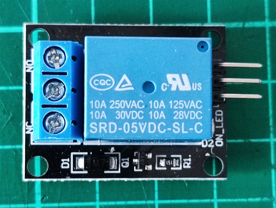

The next component which I used was the relay module. The purpose of the relay module is to turn ON and OFF the submersible water pump. Since the water pump requires a higher voltage, the relay will act as an automatic switch for the submersible water pump. Below is the image of the relay module, as well as the water pump.

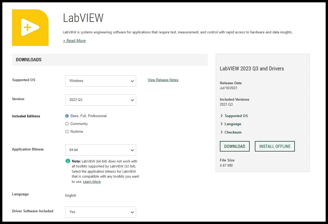

For the software development, we will be using the LabVIEW. First, need to download the LabVIEW Community Software. The installation process is pretty straightforward. Just follow the steps and you are done with setting up the software. Below is the screenshot of the download window, whereby we need to choose the OS and other things before we can start to download the software. Just be sure to select the community editions.

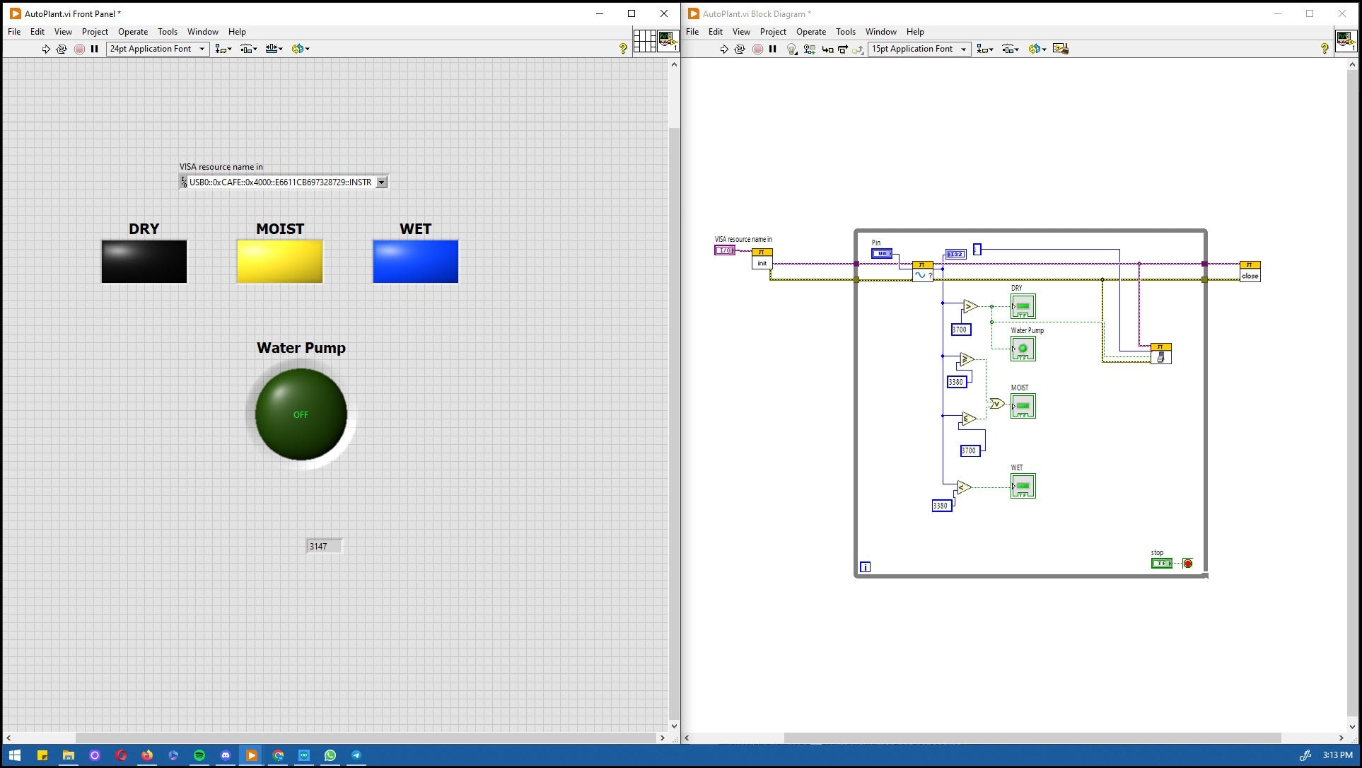

Next, we designed the Auto Plant front panel and continued with the block diagram.
