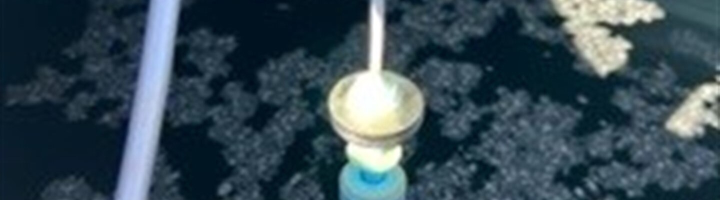

My design employs a Raspberry Pi Pico programed with National Instruments LabVIEW. In brief, the main loop in the Pico continuously monitors two elements GP8 as an input which monitors gross flow. Using a paddle type flow switch comprised of a paddle inside of a 2” pipe that is coupled to a switch on top of the device with a water-tight seal, a gross leak causes the paddle to move froward and actuate the switch above it. Along with a small capacitor to reduce debouncing somewhat and a pull-down resistor, Input GP8 receives an input High. This change of state starts a timer that counts to 1 hour and when one hour elapses, a shutdown sequence commences. Outputs: GP2 and GP7 are activated, go high, closing off the automated water source valve with a 10 second long pulse AND turning on a visual/audible alarm with a sustained High. A Wi-Fi connected alert module can be activated off that output; if desired.
Likewise, if a smaller leak prevails and there is no gross flow, but rather a small flow that drops the tank level sufficiently, an adjustable float switch is engaged when an internal reed switch senses the dropped float and turns input GP10 High. Unlike GPO8, which has a long delay, GP10 has only a 1-minute delay before it calls the same shutdown sequence. The LabVIEW VI would compare the elapsed time and "reset" to zero if the condition did not exceed the maximum time value.
- The tank level float switch.
As a bonus, the valve controller can have state switches that indicate full-open or full-closed. These can use the Pico’s 3.3V supply to set inputs GP4 & GP5 high and in-turn flip high outputs: GP18 & GP19 which have LED indicators on them. This can be handy when diagnosing problems. On a reset, a power down of the Pico and the automatic action of the valve, when the reset button is pressed, gets us back to a normal operation state, ready to wonderfully save a well.
