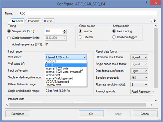

This screenshot shows the ADC_SAR_SEQ configuration dialog. You can extend the input range from 1V to 2.5V or 5V by changing the Vref select value.  This blog only evaluates the circuit with the Vref set to 1V.

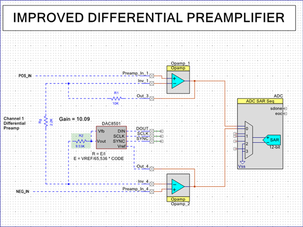

All is not lost. By use a multiplying DAC, as shown in this schematic, to compensate for resistor and other common mode error sources will improve performance by several orders of magnitude. In this circuit we are using a DAC8501 (Newark PN 38K0764) serial programmable DAC to function as a variable resistor in series with R2 such that the effective resistance is increased as the DAC code is decreased. R2 is selected such that it is equal to the nominal value (10K) minus the sum of the errors. With R1 and R2 each having up to 1% error plus the 0.5% error for the instrumentation amplifier is a total of 2.5%. Thus R2 is decreased by 2.5% and becomes 9.75K. The nearest standard 1% resistor value is 9.53K.

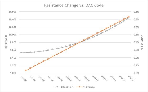

The accompanying graph shows that by adjusting the DAC value down, we can vary the effective resistance from 9.5K to 10.5K. For this graph the DAC code was decremented by 20 counts and resulted in 0.03% changes to the effective resistance which is more than adequate to adjust out all common mode errors for the entire circuit. The actual gain matching capability of the circuit is better than 0.0016% or 95dB CMRR which means you will get 12-bit accuracy from the ADC and not 4-bits over the entire common mode range as discussed earlier.
Thus, this circuit is more cost effective and space efficient than using precision matched resistors or pots. To calibrate the circuit start with a DAC code of 65196. If the measured value is negative increase the code by 20 counts. If the measured value is positive decrease the code by 20 counts. Repeat this process until the measured value is +/- 1 LSB. I am ordering the DAC and will be updating this blog over the next few weeks with sample code and measured results. Keep an eye on this post.
