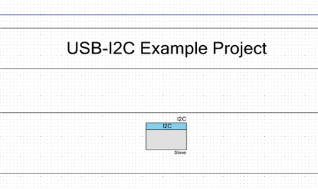

Project Schematic:

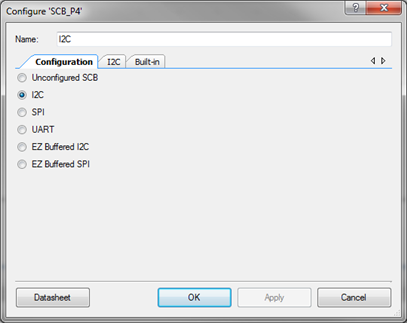

First the user will need to create their firmware for the PSoC 4 device. The project uses the PSoC 4 Serial Communication Block (SCB) component configured as a slave device.
                              (Actual PSoC Creator   Schematic "TopDesign.cysch")

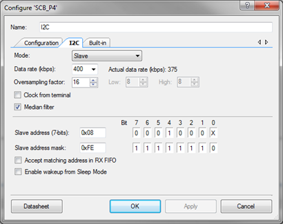

Configure the component by right clicking on the component in your Top Design schematic view and selecting Configure. Please enable the following selections in the Configure menu window.
                              (Configure menu with I2C selected)
                              (Project I2C Settings)
As part of this example we will also want to ensure that we've connected the I2C component to the correct pins. We will select pins P3[0] (SCL I2C) and P3[1] (SDA I2C). The user can do this by opening the Design Resource window from the file tree. You will see in the example the 'USB-I2C.cydwr' listed in the workspace tree. Double click this item and then select the correct pins from the pin allocation window.

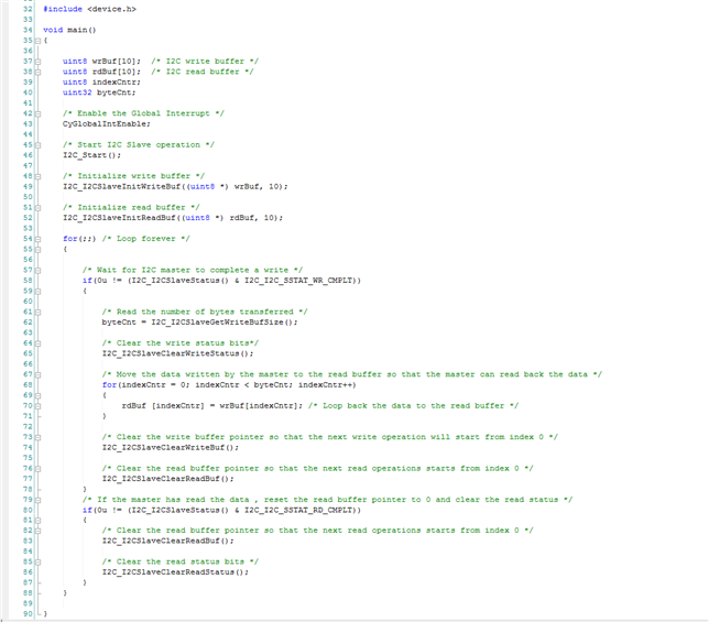

The main.c firmware in this project is very simple, it will enable the PSoC 4 device to transmit and receive I2C data to and from the BCP applciation using the PSoC 5LP as a USB-I2C bridge.
                              (PSoC Creator main.c firmware)

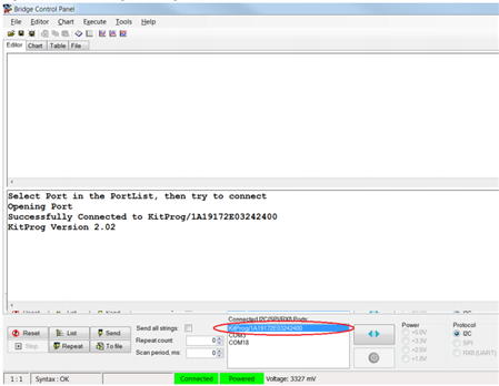

Once you have built the project and programmed the PSoC 4 device from within PSoC Creator you will be able to enable the functionality in the Bridge Control Panel. Simply open the Bridge Control Panel by navigating through the Start menu under the Cypress folder. Launch the Bridge Control Panel and select the KitProg option from the port menu.
                              (Bridge Control Panel)

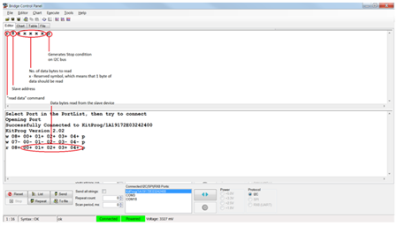

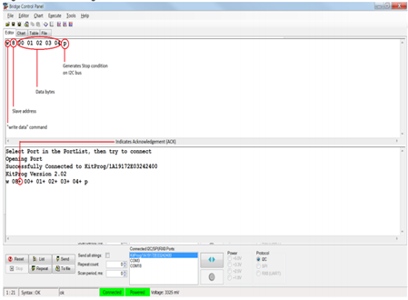

First we will need to setup the protocol configuration. You will see that under the protocol radio buttons (bottom right of the Bridge Control Panel) the I2C option is already selected. Navigate to the menu option Toos>Protocol Configuration. This will launch the configuration windows. Select the I2C tab and select the 400 kHz speed. Now that the Bridge Control Panel has been configured to align with our example project we can add in our commands to the Editor window.
Navigate to the Editor window and add the following "Write" command into the window.
w 8 01 02 03 04 p
This command will generate a write command from the Bridge Control Panel to the target PSoC 4 device using the PSoC 5LP as a USB-I2C Bridge. The command initiates a write command with a slave address of 0x08 and a set of data ending with a Stop Condition on the I2C bus. The user will then click the 'Send' button at the bottom of the Bridge Control Panel window. If this write command is successful the output window will echo back the command with '+' signs to indicate successful transmission. A failed command will have '-' signs in from of the echoed command in the output window.
                              (Bridge Control Panel write command)
We can also initiate a read command from the Bridge Control Panel to read I2C data back from the PSoC 4 device. The image below shows an example of a read command.
r 8 x x x x p
The command initiates a read command targeting a device with a slave ID of 0x08 and then asks for values from the I2C buffer. The 'x' is a reserved Bridge Control Panel character that indicates a 1 byte data value. Again if the command is successful the output window will echo back the command and indicate success with '+' signs for all passing data. For the read action the output window will display the data that has been read from the device.
                              (Bridge Control Panel read command)

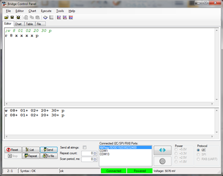

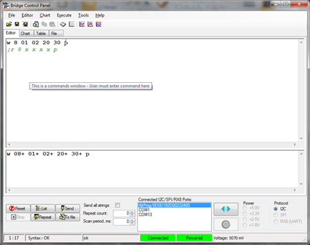

If you want to play around with the Bridge Control Panel and this example you can change the values that you are writing to the PSoC 4. Enter in the following text to the Bridge Control Panel (Note: to enter a new line in Bridge Control Panel you need to hit Ctrl+Enter):
w 8 01 02 20 30 p
;r 8 x x x x p
What this example does is to write a new set of data and then read back the values. I've used the ";" character in front of the read command to comment out the command and that is indicated by the green text. By pressing the Send button we will send the write command.
                              (Bridge Control Panel write/read commands)
Then comment out the write command using the ';' character and then decomment the read command and click the Send button. You will see that we've read back the values we wrote to the PSoC 4 device.
                              (Bridge Control Panel reading back new values)

    I downloaded the project file and successfully built and programmed it to my psoc 4. I set up the Bridge Control as stated in your instructions, but when I issue a read or write, both operations fail. I'm not sure where to start looking. I started the debugger but I quickly found out that I can have the debugger going and have the bridge control working as expected. Would you have any ideas?
    Thanks
    Gagan,
    Looking at Project #5, and working with Creator 3.0 (Component Pack 7).  Appears that some API functions may have changed from publication date to present.  Line 46 function does not exist in lates SCB datasheet; rather, I believe we're to use SCB_Start (), vs. I2C_Start ().  Can you confirm that main.c must be scrutinized line-by-line for this and other instances like it, where perhaps the SBC component may have been updated?
    Thanks for any clarifications &/or updates.
    Steven P.
    NY
    e14 Contributor over 11 years ago in reply to e14 Contributor
    Daniel,
    I downloaded the project, upgraded the components to those available in PSoC Creator 3.1 SP1 and programmed the PSoC 4. I used Bridge Control Panel (BCP) to read and write data to the PSoC 4 and it works fine. Can you please confirm the following:
    1. The I2C address of PSoC 4 is listed when you click on "List" in BCP.
    2. The I2C protocol settings in BCP are the same as in the project.
    3. You have used the correct I2C pins for SCL and SDA.
    Your response " I started the debugger but I quickly found out that I can have the debugger going and have the bridge control working as expected" says you could use the debugger as well as use BCP for I2C at the same time? This cannot be done. You can either use BCP or the Debugger at a time but not both. Can you please confirm.
