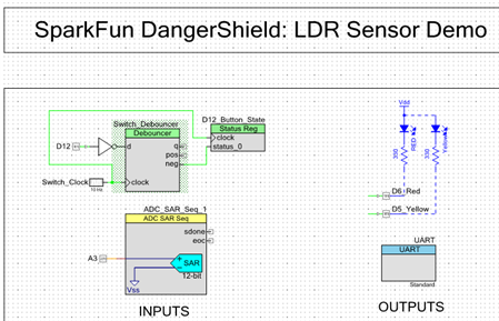

Project Schematic:

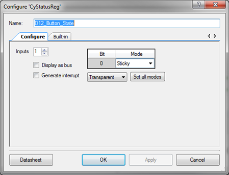

The user can download the example project at the bottom of this post. The project uses the following list of Creator Components:
  • ADC SAR (LDR sensor)
  • UART (Debugging)
  • Debouncer (Clean up switch signal)
  • Status Register (Button State)
  • CyPins (LEDs)
(PSoC Creator Schematic)

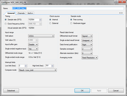

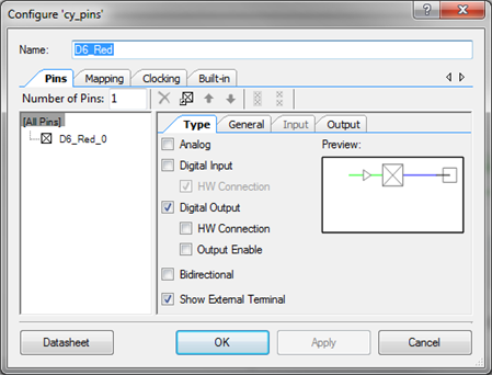

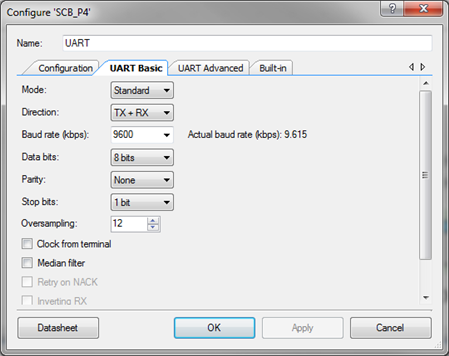

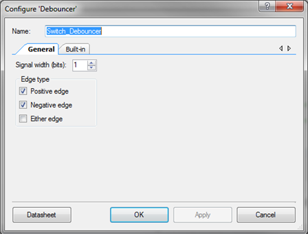

The components are configured by right clicking on the component in your Top Design schematic view and selecting Configure. Please enable the following selections in the Configuration windows for the listed components above.
(Configure menu for ADC SAR)
(Configure menu for UART)
(Configure menu for Debouncer)
(Status Register)
(CyPins)

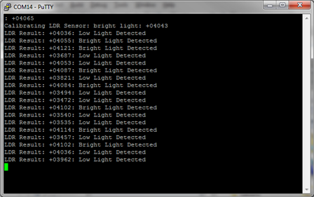

Next launch a serial interface tool like PuTTy. We dicussed this in example #04 when we were discussing the USB-UART functionality. Once your PuTTy settings are enabled click open to launch the serial window.
(PuTTy Settings)
First press the reset button on the Pioneer kit to ensure the example project starts from the beginning.
After resetting you will need to press the D12 digital button. The LED will toggle during the calibration. Press the D12 digital button again and the calibration will be complete. Then wave your hand over the LDR sensor and you will see the LED's toggle between D6 and D5.
Next view the PuTTy output window. The example will continuously output data to the PuTTy window. You will see the data change as you wave your hand over the LDR sensor.
(PuTTY Output)
