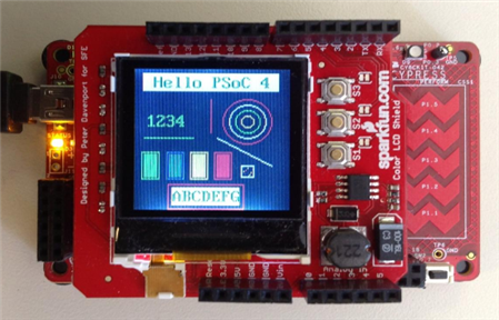

Today’s example project uses the a Graphical LCD Display Shield from Sparkfun which has a Nokia 6100 LCD. We’ve have tested this example on a number of shields that support the Nokia 6100 LCD:
SparkFun Shield
Elect Freaks
Nokia 6100 Shield
There are minor differences between the boards for controllers and brightness controls. Please check with the datasheet of the additional LCD screens linked above to find out what controller is used. This example uses the Sparkfun Graphics LCD screen.
What is unique about this example project is that we’ve created a custom Graphics LCD (GLCD) component in Creator that gives the user API controls for the LCD display. This component is not shipped with PSoC Creator as part of the general installation. The GLCD component is available in the attached example project and can be loaded into your design. This component creates an easy to use interface to write text and draw shapes on the LCD screen using APIs. Attached to this project is the Component Datasheet. In the datasheet we describe the APIs. The example project utilizes the APIs as an example. The following image is the project example output on the GLCD display. While the LCD output looks complicated you will see from the example that it uses simple APIs to create the shapes.
(Pioneer Board with the Sparkfun LCD Shield)

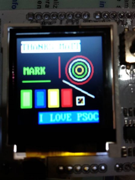

  • jesusantoniocar
    jesusantoniocar over 13 years ago in reply to cy.wbz
    Hello Matt.
    I bought the shield http://www.elecfreaks.com/store/color-lcd-shield-p-462.html, because i try to buy the spakfun shiled but it is sold out,  i see in your descirption that i can use the shield that i bought, so i will write to you when i received this and test my project.
    thanks again.

  • mhastings
    mhastings over 13 years ago in reply to cy.wbz
    If you use the brighter, cheaper, higher contrast graphics LCD from ElecFreaks, don't forget to drive the display backlight crontrol with a "1" or an optional PWM.  If you don't the display will appear to be dead.
  • jesusantoniocar
    jesusantoniocar over 13 years ago in reply to mhastings
    Hello Mark.
    Could you explain me better how can i do this  "back light"  control set up to "1", you have reason, the display looks like dead.
    thanks for your help.
    Jesus Antonio.

  • mhastings
    mhastings over 13 years ago in reply to jesusantoniocar
    Jesus,
    All you have to do is drive P3[4] high.  For an example just take a look at the dual trace scope project that I submitted.
    http://www.element14.com/community/thread/24287
  • jesusantoniocar
    Hello Matt, Mark.
    Thanks.
    It works.
    best regards,
    Jesus Antonioimage
  • cy.gul
    cy.gul over 13 years ago in reply to jesusantoniocar
    Jesus, that looks really amazing. good work!
