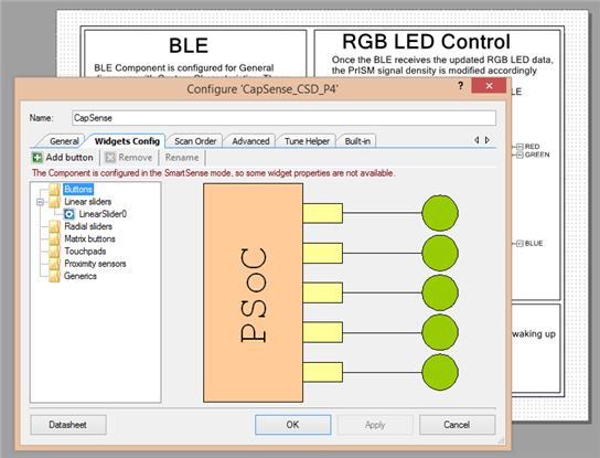

The components are configured by right clicking on the component in your Top Design schematic view and selecting Configure. Please enable the following selections in the Configuration windows for the listed components above.

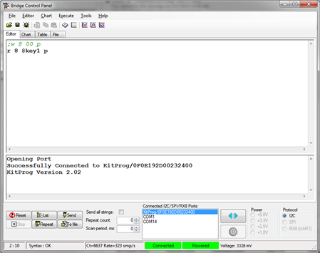

First we'll work with the write command in the editor window. You will see we use the following symbol to comment out the read command ';'. Make sure your cursor is placed on the write command line. The Bridge Control Panel uses the cursor to determine the command to send. The first command we'll send is:
w 8 01 p
To send the command click the Send button. This command sends a write command to the PSoC 4 using I2C address 8 and sending value 01. This will turn the LED off. Simply change the 01 to 00 and send the command again. You will see the LED turn on.
Next comment out the write command and decomment the read command using the ';' character. You will see that in our read command we use the '@key1' variable. This variable was defined in our INI file and associates the value received to that variable.
r 8 @key1 p

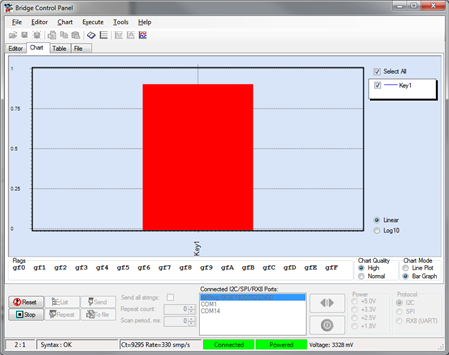

Again make sure the cursor is placed on the read command line. We can either send this command once using the Send button or we can continuously repeat this command using the Repeat button. By hitting the Repeat button this will enable us to chart the values received in real time. Click the Repeat button and you should see a stream of data in the output window. Click on the Chart tab while the data is Repeating. Then touch the CapSense button P1.1 to see the chart update with the button status.
If you happen to have the Line Plot option simply change that to the Bar Graph option. This selection is at the bottom right of the charting window.
Simply click the Stop button to end the Repeat data collection.
