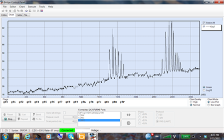

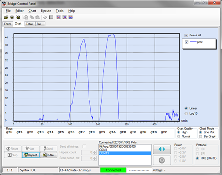

You will see the UART data displayed in the output window. Navigate to the Chart tab to see the proximity values displayed in the chart window. Move your hand around the proximity wire and see the values change in the chart. In the below image you see a plot of the values from the UART. The peaks are when my hand is close to the proximity sensor.
A key point when using the Bridge Control Panel. The PWM value is a 16 bit value in your application but it is broken into two 8 bit values when transmitted. Here the Bridge Control Panel reads those values and reassembles the two 8 bit values into a single 16 bit value. It accomplishes this by using the '0' and '1' leading values on the read variables.

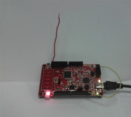

The user will need to connect a single wire to the P1[0] pin on the Pioneer Kit. The P1[0] is on the J2 header. This wire should be long and be pointed vertically away from the board. This help to reduce noise on the proximity detection.
Also connect a single wire to the PSoC 4 pin P4[1] and the Pin 9 on the header J11. This will connect the UART of the PSoC 4 to the UART Bridge on the PSoC 5LP. This wire will enable the Bridge Control Panel UART data collection. In this example we only need the TX connection from the PSoC 4 as we are not sending values to the PSoC 4.
Test Your Project:
Once the kit is programmed wait until the LED transitions from White to Red. The proximity detector is finding the minimum and maximum values. Once it transitions to Red move your hand close to the wire and see that the LED changes color as you get closer to the wire. Use the Bridge Control Panel to read the proximity value.

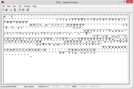

    Hello Matt. Thanks, i found the application , initially I tested the program using hyerterminal, but i test the application with Bridge Control Panel and runs great, best regards, jesus antonio

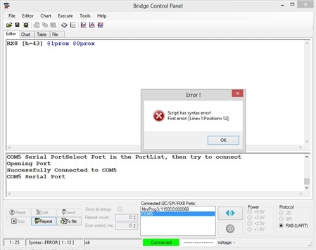

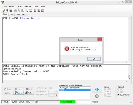

    Hello,
    When I try and run the "RX8 [h=43] @1prox @0prox" command the bridge says there is a syntax error.  Any ideas?  Thanks.
    -Walt
  • cy.gul
    cy.gul over 13 years ago in reply to e14 Contributor
    Hi Walter,
    Corrected Response -

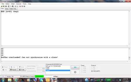

    The variable name by default is "Key1". By going to "Chart > Variable Settings" you can rename it to "prox" or whatever else you'd like.
    When doing so, please also remember to change the variable type to "Int" and check the "active" box --> this is important!
    The default syntax would be "RX8 [h=43] @1Key1 @0Key1" (if you don't change variable name).
    Hope that solves your problem!

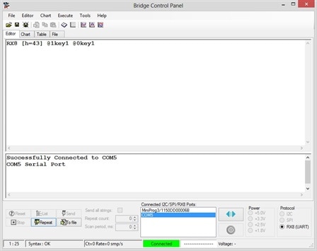

  • jesusantoniocar
    jesusantoniocar over 13 years ago in reply to cy.gul
    Hello Gagan.image
    it is the new mesage in the display:
    Best regards,
    Jesus.
  • cy.gul
    cy.gul over 13 years ago in reply to jesusantoniocar
    Hi Jesus,
    please note -
    In the above command we have a variable named 'prox'. We add a leading 1 and 0 to the variable to indicate that these two values should be stitched together to create a single value and assign that value to 'prox'. If the '0' and '1' values are placed after 'prox', for example prox1 or prox0 then this indicates two separate variables. For more information on this please take a look at the Bridge Control Panel user guide.
  • jesusantoniocar
    Hello Gagan.
    I changed the parameters and right now can see the signal by bridge control panel.
    thanks.
