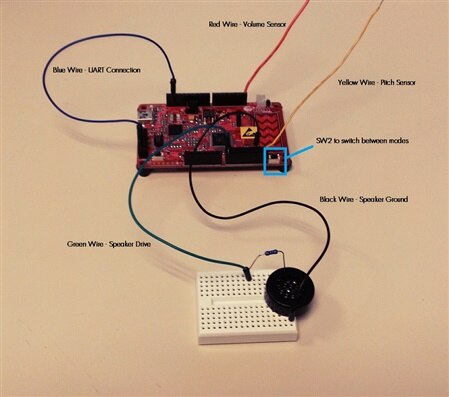

Today's project is a personal favorite of mine because it got the amateur/wannabe musician inside me very excited. Building on yesterday's example of how to do proximity sensing with the CapSense Component, today we're going to use that concept in an application. This example project implements a Theremin, a 1920s electronic musical instrument played without physical contact.
The project uses two proximity sensors - one for Pitch and another for Volume. The proximity sensing itself is done using wires that act as antennas, input to the PSoC 4 using the CapSense block.
The theremin has 2 modes - discrete and continuous notes, toggled by using the pushbutton (SW2) on the board. Pitch information is indicated by the color of the LED, while Volume information is indicated by the brightness of the same LED.

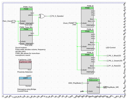

The Cortex-M0 CPU takes the analog input from the CapSense proximity sensors and send a parameter indicating distance to the hardware PWMs, that in-turn modulate the LED. The CPU also sends data to the 2 other PWMs that are used to drive the a Buzzer that creates the musical notes.
The project also includes a UART Component so you can read the CapSense proximity sensor data over hyperterminal.

- It uses 5 (five!) hardware 16-bit PWMs - 3 of which are implemented on the TCPWM block (modulating the RGB LEDs), wheres 2 more implemented using UDBs (to drive the buzzer).

Hardware Connections:
The RGB LED and the pushbutton switch are on the board. In addition to the PSoC 4 Pioneer Kit, you're going to need -

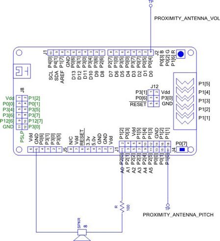

- an 18 ohm Speaker/Buzzer (P2[0])
- 2 resistors, 2 capacitors
- hanful of jumper wires
The project is attached below, its all ready to go. Just build and program on to your PSoC 4 Pioneer Kit, and wire up a small buzzer.
Have fun making music!

    e14 Contributor over 13 years ago in reply to greatunclebulgaria
    Hey David,
    Great question.
    Actually, you need just one 100ohm resistor and one 8ohm/0.1W speaker (see image below). You could use a speaker with a different rating as well - for this application, it doesn't matter too much. I have tested it out with speakers with different ratings, and get similar results.
    Makes sense?
    Thanks for the question,
    Antonio

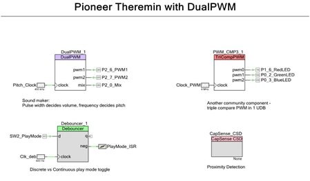

    e14 Contributor over 13 years ago in reply to e14 Contributor
    Hello, all,
    This just in:
    By implementing some of the Theremin functions in UDBs, I have written a much more efficient Theremin.
    1. Instead of two 16-bit UDB PWMs (4 UDBs) for Tone generation, there is now a single 16-bit DualPWM that does the job in 2 UDBs
    2. Instead of 3 TCPWMs for RGB LED Control, there is a single 8-bit triple-compare PWM.
    This new project thus saves you 3 TCPWMs and a UDB over the previous example!
    Here's the new schematic:
    The project can be found in the Cypress Community Component forum: http://www.cypress.com/?app=forum&id=2492&rID=82045

  • wire67
    wire67 over 10 years ago in reply to e14 Contributor
    Hi,
    Just a little electronic correction for the value of the serie resistor:
    The absolute maximum current per GPIO of PSOC 4 is 25mA
    Rspeaker = 8ohm
    Vdd= 3V3 (or 5V? here take the absolute maximum)
    the resistor must be strictly greater than : Rmin = Vdd/Igpio-Rspeaker = 3.3/0.025-8 = 124 ohm
    add 10% if it's a E12 series resistor: 137 ohm -> take a 150 ohm
