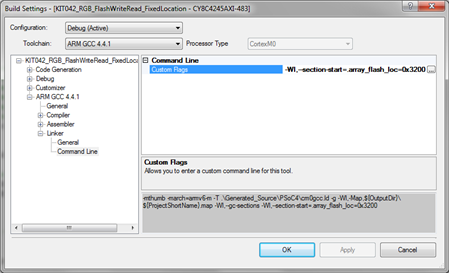

We have expanded on the example #014 posted earlier in our series. In that project we were writing the LED value to a flash location so it can be remembered when power cycling or reseting the device. Due to the settings in the original project we allowed the linker to define that flash location. In this example we have updated this project to specify an exact flash location.
In this example we have modified the flash data array define text to:
#define FLASH_LOCATION __attribute__ ((section(".array_flash_loc")))
In this line of code we are pointing the flash location to a defined area. We will need to ensure that the linker has this value defined.

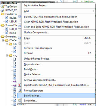

Navigate to the workspace explorer and right click on the project to launch ‘Build Settings’.
Under the Build Settings window select Linker>Command Line from the option tree.
Define a custom flag and add the following command in the text editor:
-Wl,--section-start=.array_flash_loc=0x3200
Click Ok and then navigate back to your project and build the example.
