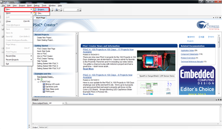

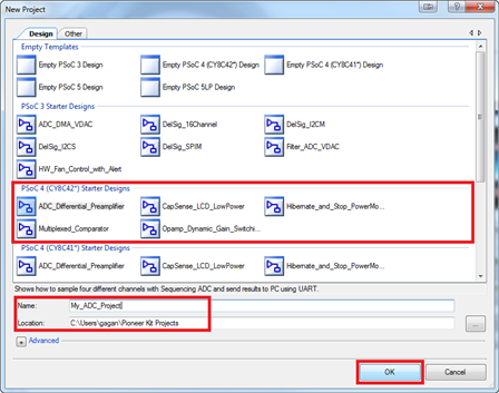

1. Launch PSoC Creator and start a New Project from the File menu
2.From the New Project window, scroll down to see the Starter Designs for the PSoC 42xx family. Here, you can select from the 5 included starter designs. You can also provide you own project name and path, and then press OK to create a new copy of this project on your computer.

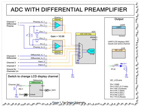

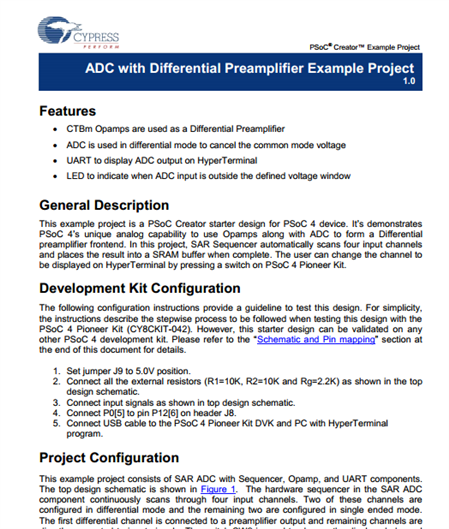

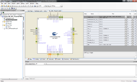

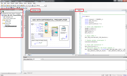

3. In this example, I picked the first starter design "ADC_Differential_Preamplifier" and named it "My_ADC_Project". Once this new project is created, you will observe the already completed project schematic (topdesign.cysch), the project firmware (main.c) and also a document decribing this project in details (ADC_DiffPreamplifier.pdf).
4. To learn more about this particular project, see the included PDF document.
5. Finally, assign the GPIO for your project based on what target hardware you are going to run it on (e.g. the PSoC Pioneer Kit). Once completed, you can then Build and Program this project on your PSoC 4 Pioneer Kit.
