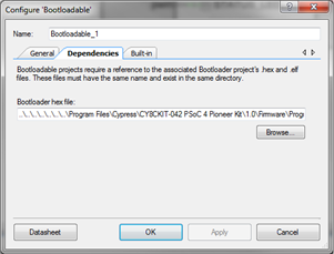

In our example we are going to create a simple blinking LED using a PWM. The example project below includes project design, components and routing. The only addition to our project is to add the ‘Bootloadable’ component. We must double click on this component to open the component options menu and select the dependencies tab. In this tab we must add the Bootloader hex file path. You can navigate to the kit install path:
…\Program Files\Cypress\CY8CKIT-042 PSoC 4 Pioneer Kit\[Kit Version]\Firmware\Programmer\KitProg_Bootloader\KitProg_Bootloader.hex

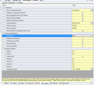

We need to ensure that the bootloadable file we are trying to create matches the same form and structure as the bootloader that is on the PSoC 5LP. This will allow us to boot in our application code over the USB interface.Next go to the DWR selections for 'System' and configure your settings:

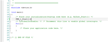

Next we will need to add in a little code in our main.c file. This code will start the PWM. In this example I’ve implemented the PWM and LED control in hardware so there will be no need for any C code to control the PWM or LED. All we need is a single line of code to start the PWM. Build and compile this example.
