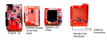

This project demonstrates interfacing an I2C EEPROM chip to the PSoC 4 device to backup data. A 5 letter word scramble game has been developed as an example. The game saves and retrieves the scores and the used words. The data is retained on power off and power on conditions using the I2C EEPROM.

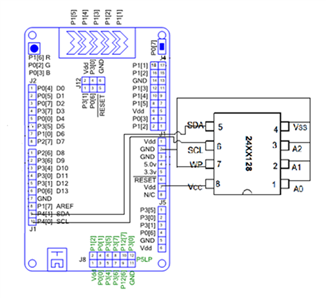

In this example you will need to have the Pioneer board connected to the protoshield and the GLCD shield. In this example we used the sparkfun GLCD and protoshields. On the protoshield we mounted the I2C EEPROM 23LC128 device. The following is a schematic of the EEPROM wiring.
