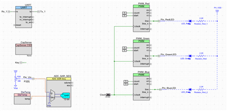

Project schematic:
Firmware description:
Firmware is composed of main.c containing the application, and the sn_cfmsg.c/.h containing the SNP Compact Frame/Message Layers.
The ISOTEL SNP - Message Layer specifications provide a compact math enriched content description, making your device a 'web' like box. Message layer defines a two kind of messages:
  1. content description, the static part typically exchanged only once contains elements such as text formatting, data structures, variables, expressions with precision and accuracy calculation, ideal for sensor applications,
  2. dynamic part consisting of arguments exchanged in PSoC4 native format, and are exchanged on value change, either on PSoC4 side or user side. No conversion needs to be done on the PSoC4 side for either input or outpt, preserving maximum precision, accuracy, and releasing the CPU power requirements.
Regarding this project, the PSoC4 application needs to implement three functions only:
  • sn_cfmsg_reqdesc: provides an app content description, which are send out only on request,
  • sn_cfmsg_send: provides parameters,
  • sn_cfmsg_recvargs: a handle that receives parameters from user input.

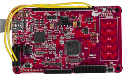

Hardware connections:
You will need to wire the UART TX and RX pins between the PSoC 4 and the PSoC 5LP on the pioneer kit (See picture below).  There are no other hardware connections.

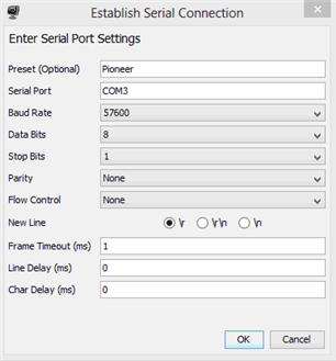

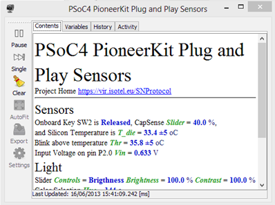

Test your project:
  • You will need to download the SNTerminal software written in JAVA.
  • Program PSoC 4 Pioneer Kit with attached PioneerPnPSensors project.
  • Double Click on the SNTerminal-130624-1.jar software should start the application automatically if JAVA JRE is installed correctly. If serial device driver is properly installed it will be listed on the bottom line of the start page. Click on it, enter the COM settings below and click OK. If everything is okay the DeviceView dialog appears as shown in the picture below.
image     image
Please read SNTerminal User’s manual or watch the video for more details.

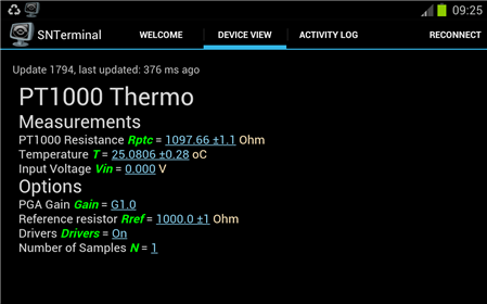

    A photo how it interacts with some other board (PSoC1 with USBUART component):
    Best, Tomi

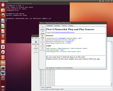

    Hello!
    I am new in the topics around pioneer board. First I wanted to try to install on it the Project#040 - PioneerPnPSensors with the nice SNTerminal.
    First I started from the 50 project boundle archive, but it seems, it hasnot up-to-date docs, it dont has instructions how can reprogram the USB port to access it as a serial device.
    When I found this online howto, and followed the stepps, it started on my android tablet, and on a Windows XP desktop.
    I am a linux user, and wanted to see it on my ubuntu desktop too.
    From the attached usb2uart_cdc.inf file, it become clear, the communication between the SNTerminal and the pioneer board based on the old CDC_ACM driver. The majority of the linux distributions have such module/driver, usually in the
    /lib/modules/..../kernel/drivers/usb/class dir, in the name cdc-acm.ko
    But the problem is, it dont recognize the usb ID-s of the Pioneer board,s C58xx devices, this are: VID - 0x04B4 and the PID - 0xF13B
    In this case, we have some options solve this problem:
    - we can reprogram the firmware in the USB device, use a "known" ID-s pair by the linux module. You can see the part of this alias list bellow.
    - you can recompile the cdc_acm module, extended with this new ID,s
    - the most simple way to modify one of the "know" pair in the binary file. I choosed this option, used hexedit, to change one of the first alias pairs.
    After this "dirty" mod, when I loaded with modprobe the cdc-acm module, appeared in the /dev dir the /dev/ttyACM0 device, and when I started the SNTerminal, it recognized this new serial device. Need to modify the parameters (at least the speed to 57600 bps) and it start to communicate with the board. Maybe, there is another, more simple solution too?
    Many thanks for this interesting, nice application.
