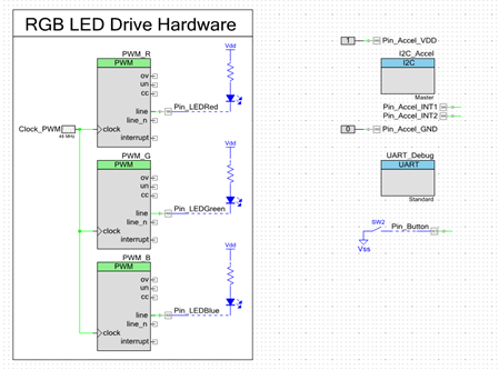

The components are configured by right clicking on the component in your Top Design schematic view and selecting Configure. Please enable the following selections in the Configuration windows for the listed components above.

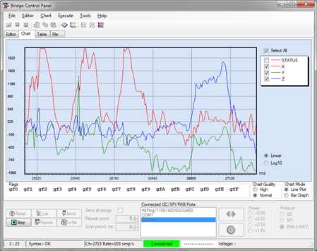

We then report the 3 axis positioning over the UART bridge so it can be reported up to the Bridge Control Panel. We are able to chart our positioning in real time using the chart features. You can use the following Bridge Control Panel command to read out the values from the PSoC 5LP USB-UART bridge:
RX8 [h=43] @STATUS @1X @0X @1Y @0Y @1Z @0Z

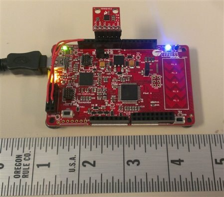

You will need to solder on a male connector to the sparkfun 3 axis accelerometer. The header will be connected into the Pioneer board Arduino headers. Connect the accelerometer into header J3 using Pins 1-6. Ground should be pin 1. Please be very careful when plugging this in as you might reverse the polarity on the power and ground connections and hurt your accelerometer. Please see the below image for the correct orientation.

    Matt, we really need to put out the example with the efficient 8-bit PWM for RGB LED control... This using of 3 TCPWMs is ouchy :| (It could be a word, you know)
