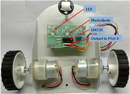

Today’s example continues to expand on the previous robot examples. In this example we are having the robot follow a black line that is printed onto a white surface. In this example we are using LED photodiodes to sense the line below the robot and then control the motors to keep the robot on track. The following hardware is used in this example:
  • PSoC 4 Pioneer Kit
  • ArduMoto shield
  • Custom Robot hardware
  • AA battery pack

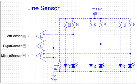

In this code example we are expanding on the obstacle avoider and adding two source files to our example. These two files are LineFollower.h/c. These two source files are used to detect the line position and control the motors. The code looks to detect the line using three sensors. The robot uses the sensors in the following configuration (Right, Center, Left). Detection from any of the three sensors will direct the robot in a defined direction or course correction.

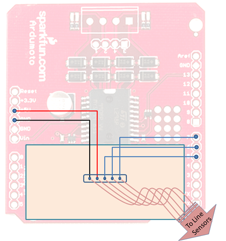

Hardware Connections:
Connect your Pioneer kit to the ArduMoto shield. Then connect your motor shield to the photodiode board.
The following hardware components are used: Red LEDs 3no.s, 220Ω resistor 3no.s for LED current limiting. Photodiodes 3no.s, 10kΩ resistors 3no.s for Photodiode biasing,IC LM339 and 10kΩ potentiometer, connectors to take out signals on prototype area of ArduMoto Shield.
