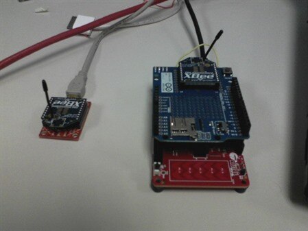

Today we will be covering our first wireless XBee example project. We will be using the following hardware in our design:
  • CY8CKit-042
  • Arduino wireless shield board
  • XBee wireless module
  • Sparkfun explorer USB
For more information on the XBee wireless module please see the linked Datasheet.
In this project we have two separate boards communicating using the XBee wireless modules. The first board is the Sparkfun Explorer USB board. This creates a simple USB to UART bridge and communicating with the wireless module. This board then appears to the user as a COM port in their device manager. We will use the hyperterminal program to read in and send out values over the XBee module. This will be our main hub of our wireless system connected to our PC. Just to note, the Explorer board can be replaced by a Pionner board where the PSoC 5LP device is connected to the Wireless XBee module.
The second board will be the Pioneer board using the Arduino wireless shield board with an XBee wireless module attached. In the image of the example project I’m using the SD card wireless shield. There’s no difference between the Arduino SD wireless card shield and the standard wireless with respect to XBee, only the price of having the ability to write to an SD card.

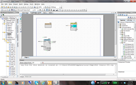

    • Project Schematic
    • Component Configurations

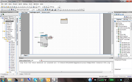

Components Used:
The user can download the example project at the bottom of this post. The project uses the following list of Creator Components:
  • UART
The components are configured by right clicking on the component in your Top Design schematic view and selecting Configure. Please enable the following selections in the Configuration windows for the listed components above.
Firmware Description:
The main.c firmware is included in the example project. Please review the commented sections for more details.

Hardware Connections:
This project requires the user to connect their Pioneer board to the Arduino Shield board and insert the XBee wireless module into the shield board.
The user must also connect their XBee wireless module to the Sparkfun Explorer board and then.
Both the explorer board and the Pioneer kits will be connected to the PC.

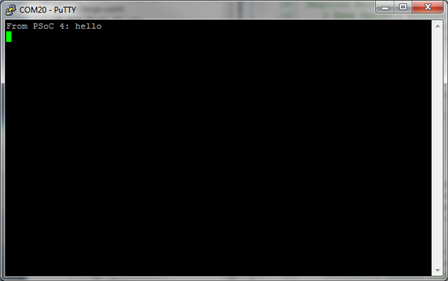

Test Your Project:
Once you have configured the wireless modules, program your PSoC 4, and connected to the XBee module on the Explorer board through the COM port, begin sending values over the hyperterminal software to the PSoC 4 device. The followig image is the response from the PSoC 4 after sending the value "hello" and then striking the Enter key.
