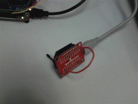

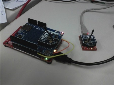

Hardware Connections:
This project requires the user to connect their Pioneer board to the Arduino Shield board and insert the XBee wireless module into the shield board.
The user must also connect their XBee wireless module to the Sparkfun Explorer board.
Both the explorer board and the Pioneer kits will be connected to the PC.
Enable the PSoC 4 UART connections to the PSoC 5LP.
PSoC 4 P4[1] -> P5LP P12[6]
PSoC 4 P4[0] -> P5LP P12[7]

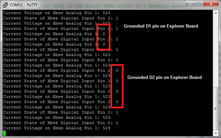

Test Your Project:
Once you have configured the wireless modules, programmed your PSoC 4, and connect through the COM port to the Pioneer Board, you will see the hyperterminal software updating the values every second.
Then take a wire and flip over the Sparkfun Explorer Board.
Short the GND and DIO1 vias. You will see the hyperterminal update it’s corresponding display.
Take the same wire and short the GND to DIO2 you will see the reported value go to 0.
Next take the same wire and short the 5V via to DIO2, you will see the displayed value go to ~1000.
